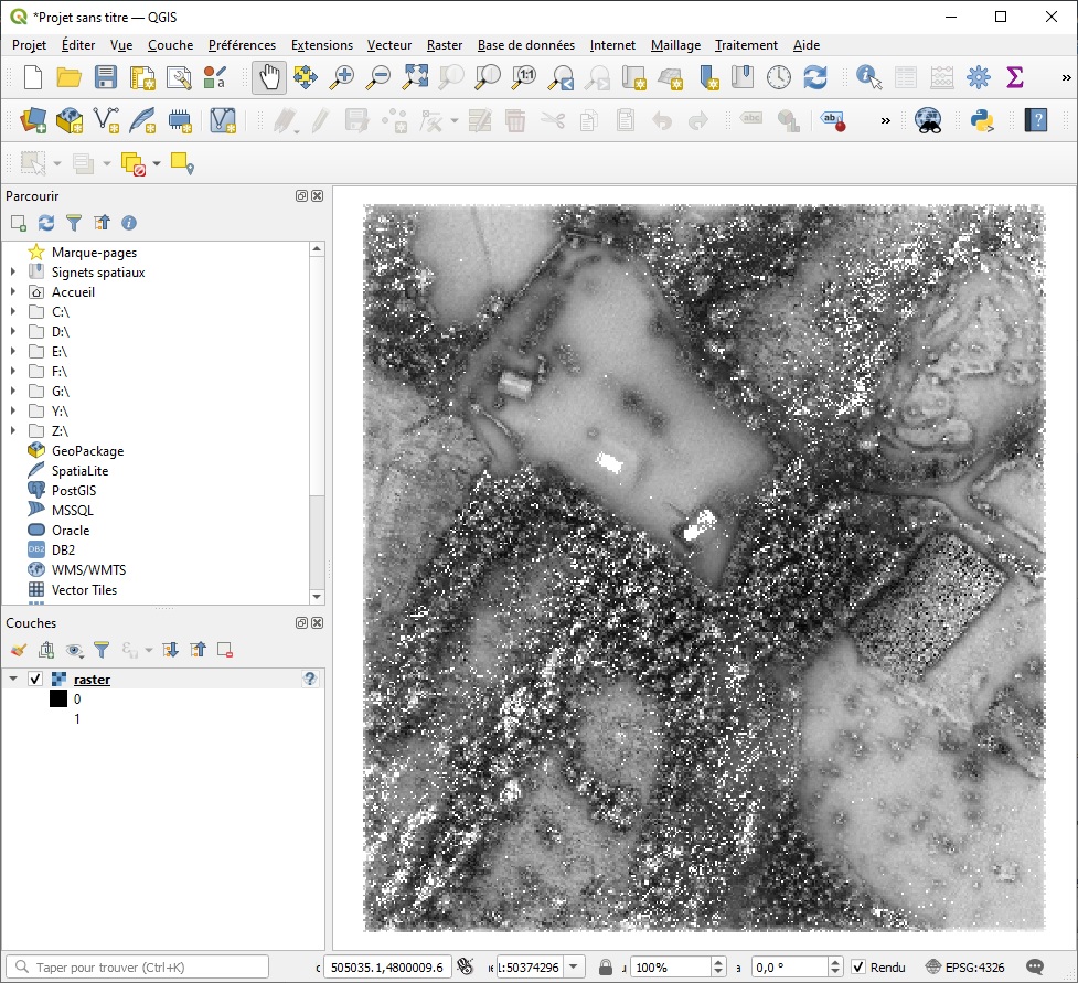

Re: Raster Export
With the version 2.12.alpha (online), I am able to export the raster without any warning, and to open it in QGis for instance:
