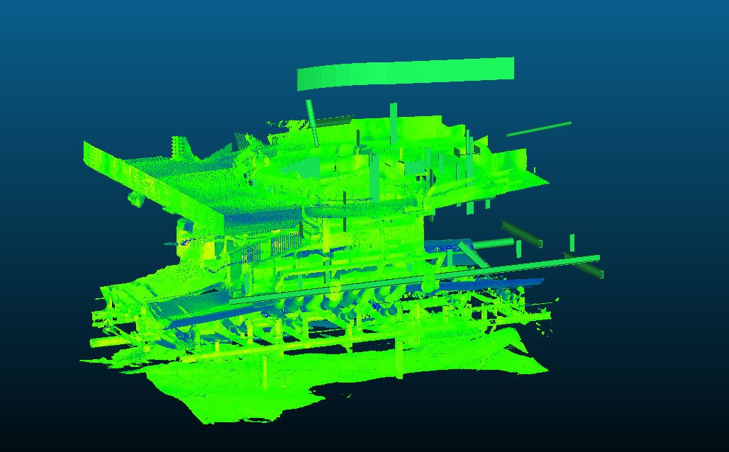

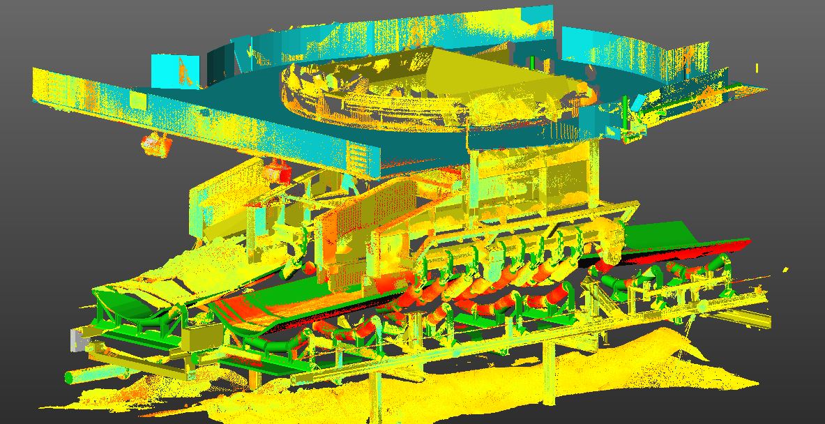

When importing a PTS and STL file which are aligned to each other(which I have confirmed in other software - see image) however
not in real world coordinates and therefore sitting around coordinate 0,0 cloud compare does not prompt for a global shift and
the two files are imported with a shift between them and are not aligned.

See attached for Aligned and Misaligned screenshots(note the STL being imported into cloud compare are a subset of the full model).
