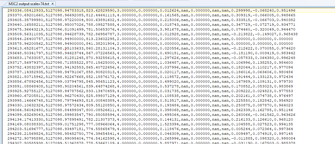

To see the raw data I saved the cloud as a txt file. There are 12 columns. The first three are the coordinates x, y, z, and the last three the normals Nx, Ny, Nz. How can I know which scalar field are the others?

Example of the txt file in textpad
Annotazione 2020-04-06 130031.png (71.5 KiB) Viewed 10415 times

Sorry, just for the records (I already replied to your email):
When you export the cloud (as a TEXT/ASCII file) you have an option to export a header (and especially the "columns title").
