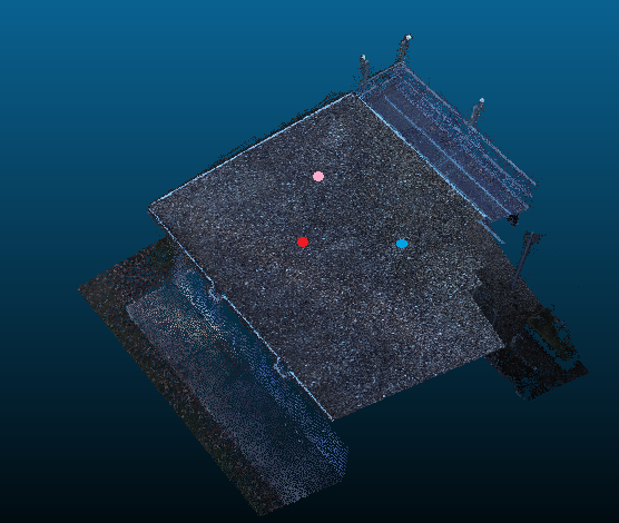

One more question!
Can I change the color of picked points?
That is, the color of firstly picked point is default color and the second is red, third is green....
How can I change the color per point?

Sorry for my bad writing. The point I wrote was not the point of point cloud, but the mark of selected point.
Re: Save/Load picked points
Ah! Then currently I don't think it's possible to change it.
You would have to change the 'label' code slightly (but this contribution would probably be welcome!)
