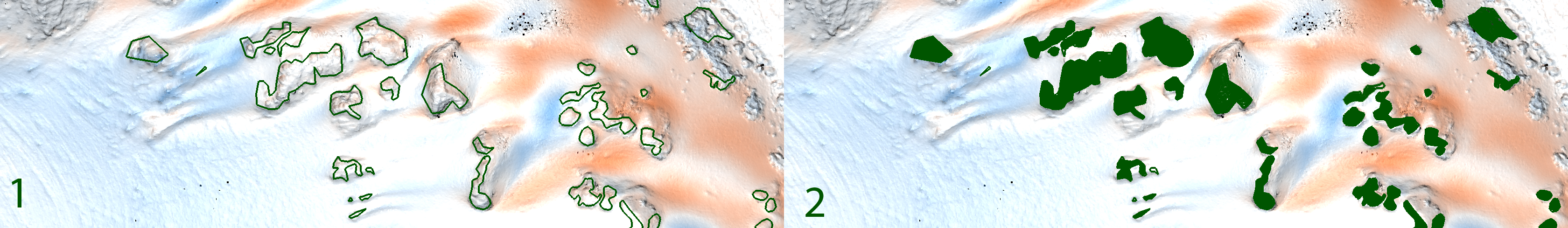

i am working on a vegetated dune. Data consist of point cloud, orthophoto, DEM. Somehow i have to mark the vegetation present on the dune. qCANUPO is not the best solution, as it should be clearly visible where vegetation is present.
So up until now i marked in Globalmapper in the corresponding orthophoto every plant as an area using polylines (tedious, but oh well), i exported all areas as *.dxf and connected it to elevation values from the corresponding DEM. This gives the polylines altitudes so i can load the dxf file into CloudCompare on top of my 3D M3C2 result.
BUT: only the lines are visible in CC and the area within is not filled with colour. I am able to change the colour of the outline, but how can i fill every "closed" polyline? Is it possible to do so inside CC? Is there maybe a workaround in Globalmapper (maybe i need to export from globalmapper to another file format?)
The picture makes it more clear what i want :) (did that manually in photoshop)

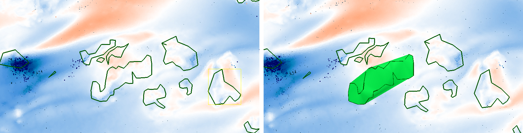

thanks for the reply. It got me to the solution. Inside CloudCompare i was able to create a polygon from a polyline under "Tools - Projection - Contour Plot (polylines) to mesh". But it got the wrong result as shown in figure. Every option inside "Edit - Mesh" was grayed out when highlighting a polyline.
