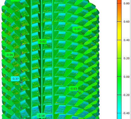

Hi!
I was wondering, is there a way to display mesh to mesh distance at a certain point? I'm currently using cloudcompare to compare a 3d-model to its 3d-scanned, 3d-printed version. I'll attach a print screen from a company that performs thesae type of measurements. This is basically what I'd like to be able to do.
Thank you!
Re: Mesh distance flags
To do this in CloudCompare you currently need to convert the mesh (with distances) to a dense point cloud (with ('Edit > Mesh > Sample points', and then don't hesitate to use a lot of points). Then you'll be able to create labels with the distance anywhere you want by either left clicking on a point while holding the 'SHIFT' key, or by using the 'Point picking' tool.
