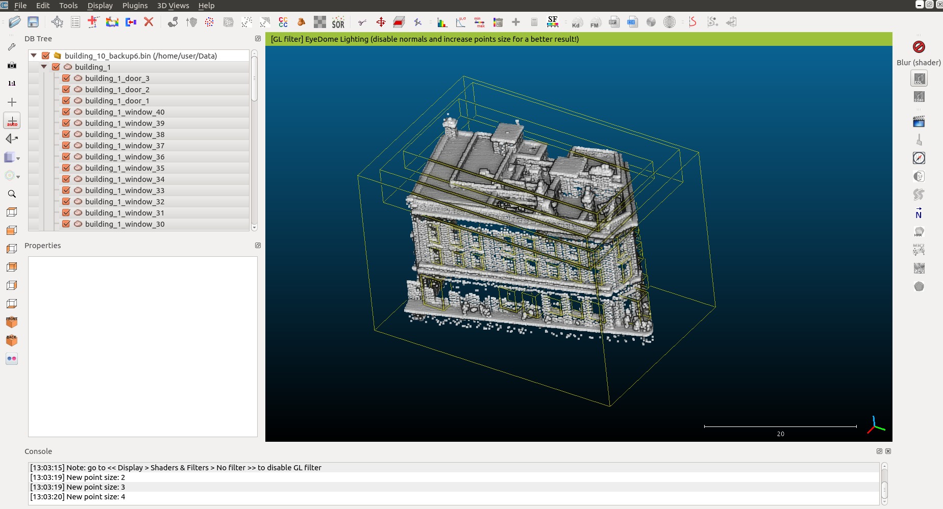

First of all, thank Daniel for developing such handy software. Here is the question:
- In short:
Is there any way to save/export sub-groups (i.e. all children of a branch) with their name?
- Explanations:
I have several big point cloud that each is manually segmented in many sub-groups (e.g. windows, doors, etc) labelled with their names (attached figured). I need to save them with their names separately. Once I save them all in ASCII format, it actually saves them all separately, but, replace their name with something like 0001, 0002, 0003, ...
Also, saving all branches one by one is very time consuming and almost impossible. Could you please help me with that?
I really appreciate your time and support.
Many thanks

Nope sadly, that's not implemented like this. However if you are able to compile CC yourself (?) I could point you to the right line of code that you could hack to change this behavior.

Looking at the code, I realize that it may already work if you use 'cloudname' in the output filename for ASCII files. CloudCompare will automatically replace 'cloudname' by the actual cloud name.
Can you try that?

That worked Daniel! You are awesome :D
I also noted that all sub-group (children of a branch) should be in the same level, as well.
