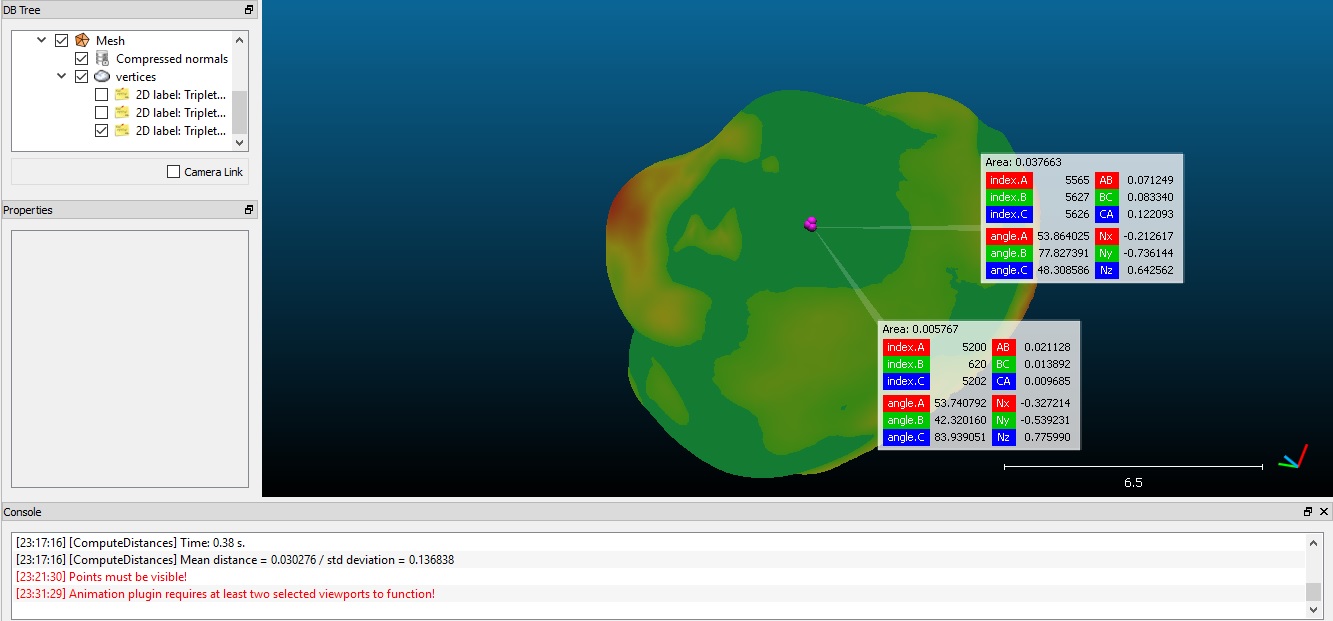

But, i believe that SHIFT+left click in the point cloud A and cloub after compute the C2C (Cloud-2-cloud distances), can be more appreciate, however i know a little subjective, because my objective is know with accuracy distance between two points in the mesh, since the software computed difference complete distance in the two clouds. My objective is academic (MsC student).
Sem título.jpg (138.17 KiB) Viewed 4265 times

You can actually sample (a lot of) points on the aligned mesh (for instance), then compute the distances between the resulting cloud and the reference mesh. This way you'll be able to pick any point you want (and not only the vertices).

Re: How know difference(x,y,z) between them in an specific point?
Use the 'Edit > Mesh > Sample points' after having highlighted the 'aligned' mesh.
