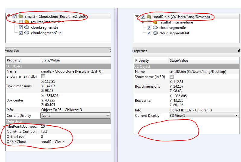

I just tried to write the meta data into my generated group object (see the images). No problem to add metadata in the group, but after have saved into a bin file, I found the meta data lost when I load the bin file. But the meta datas added to the point cloud and sub-group are still there. Have I done something wrong?
Re: Need advice for plugin developpement
That's odd, because meta-data elements are hosted by the ccObject class (and saved/loaded by this class) and the ccHObject class inherits by the ccObject). I need to test this on my side.

Have you really saved the first group in the BIN file? It should be restored when you load the file (here the first group on the right is actually the group automatically created by CC to store the entities).

At first I open a cloud named 'small2-Cloud' (not seen in the picture) and CC creates the first group, then my plugin does some processing. When it finished, it creates a new group 'small2-Cloud.clone' (as the left side in the picture) just below the first group. It's a ccHObject and it contains 3 children as in the picture. I used ccHObject->setMetadata() to add elements to each object. Then I select only the new group and use the 'Save' button to save it to a bin file.
The result: Only the meta-data of the parent group is lost, the meta-datas of the 3 children in the group are restored in bin file.
What I mean is that the "small2.bin (C:/Users/liang/Desktop)" group on the right (once you reload the data) is not the group created by your plugin. This is why it has no meta-data. I just don't know why this group disappears in your process...
Can you make another test? Can you move your group ("small2 - Cloud.clone [Result n=2, d=0]") under another group (you can create one by left clicking anywhere in an empty area of the DB tree view). Then select this other group and save it as a BIN file. When you reload the BIN file, do you get your original group back?

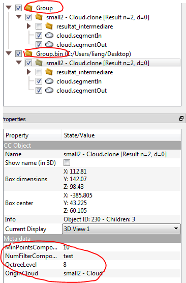

If I understand it correctly, make the group "small2 - Cloud.clone [Result n=2, d=0]" as a sub-group of another one and save the new group as bin file. In this case no problem! (Please see the picture).
Then it means that CC discards the first group when it saves it to a BIN file in your case... I need to find why.
