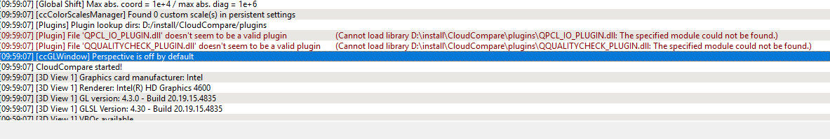

I understand, thank you, I'm not changing anything in the cc code, I'm creating a plugin for it, but we want the plugin to be installed along with cc, so these doubts about how to generate the installer, I was able to generate the installer here successfully, I am having problem with my release of cloud compare, when I put the build on a computer that does not have the pcl sdk installed it error loading the plugins that use pcl, in my case the plugin we are creating it uses pcl, I will send an image for you to see, we are compiling using cmake, on the machines that have sdk of pcl installed it works without problems.

<rant>Could you avoid double-spamming the forum AND github... Developing CloudCompare and answering all these questions is not my paid job (we are all doing this on our free time) and if we don't answer, it's really because we don't have the time... So for this question, see my answer on github</rant>
