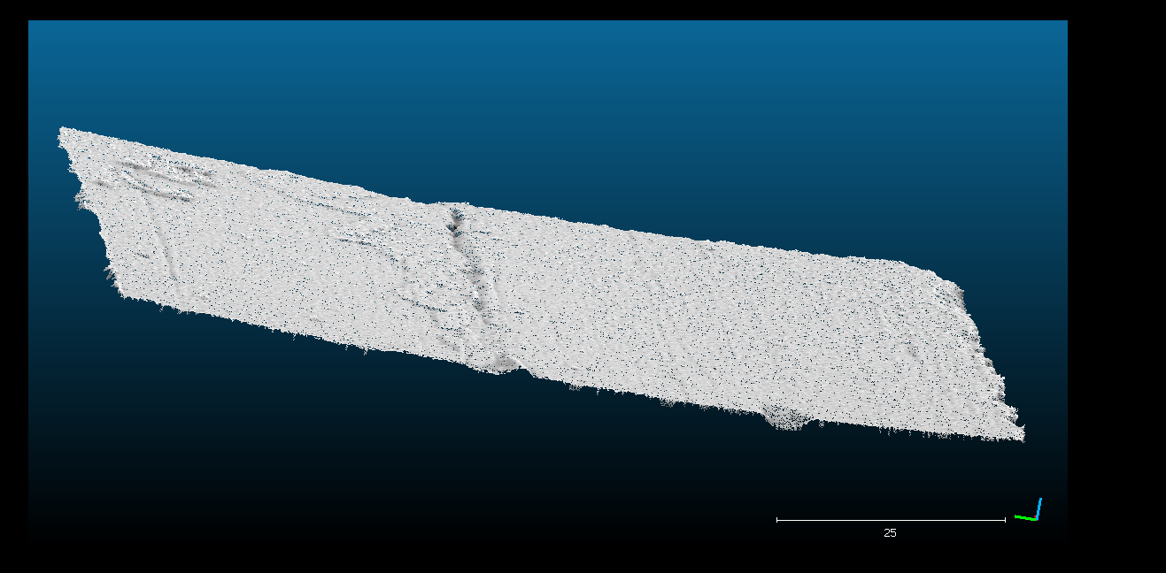

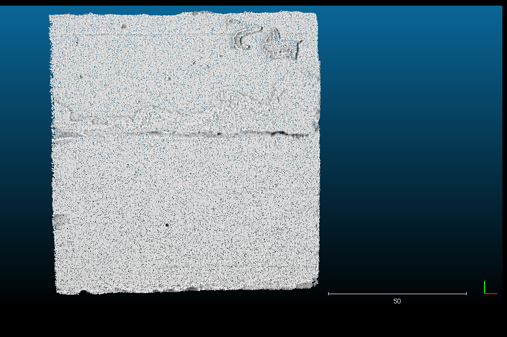

If you have a curvy object like the one below, how do you fit them? I normally use Fit>plane but it does seem working for this. I also have tried others but still not working. What is the best fit? I have looked at a curvy object where is the best fit is quadric, but I have tried it as well and it doesn't look right.
Curvy object
Curvy object
- curvy sample2.PNG (356.98 KiB) Viewed 11367 times
- curvy sample.PNG (239.5 KiB) Viewed 11367 times

Well, I'm not sure what your problem actually is: the 'Fit plane' fits a plane (flat, planar) on the selected cloud. The fitting relies on the Least Squares formulation (i.e. minimization of square distances).
The Quadric fit, will try to fit a 2.5D Quadric (see the equation here: http://www.cloudcompare.org/doc/wiki/in ... it_Quadric).
I'm not sure what you were expecting.

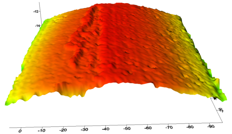

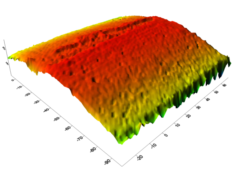

The problem is I get a very curvy surface, so I'm not sure what fit to use for the surface I have uploaded.I was expecting the surface data to be corrected as sometimes the scanner not facing the surface well.
- 2.png (460.61 KiB) Viewed 11330 times
- 1.png (363.3 KiB) Viewed 11330 times

Well I guess the Quadric should do the job. Otherwise there's no other option in CC anyway.
