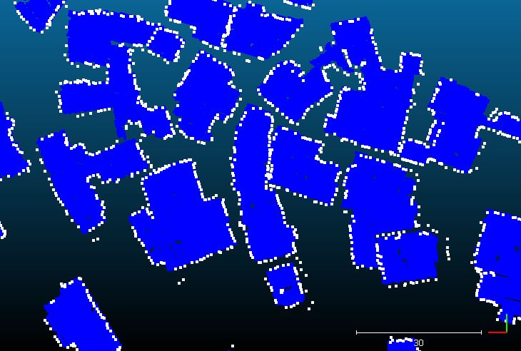

Re: Converting transition colors to solid color
Okay I extracted the class 6 from the LAS cloud (for the roofs) and the class 2 (for the ground).
Then I used the 'Closest Point Set' tool with the ground (class 2) as reference and roofs (class 6) as compared (the opposite of what I told you I believe ;).
And then I get a not that bad result:
I mean it would be hard to get a much better one. Apart maybe by playing with the scalar field beforehand (but I won't have to try).
