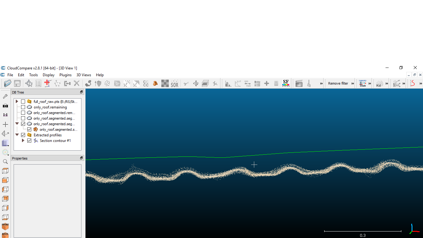

Hello!
I had been trying the extract sections tool to bring the profile of the point cloud along a polyline as shown in the figure. However, the next time i tried the tool, it was giving the following profile. Previously it was a nice representation of the point cloud. Is there something that I am doing wrong. I believe I have followed the same steps. I need to extract the profile in order to measure the distance between the peaks of the cloud.

Hum,
Not something I'm aware of. Have you tried with the latest 2.9 version?
And what about the 'min edge length' parameter, is it too small enough?
Otherwise don't hesitate to send me your data so that I can test on my side.
