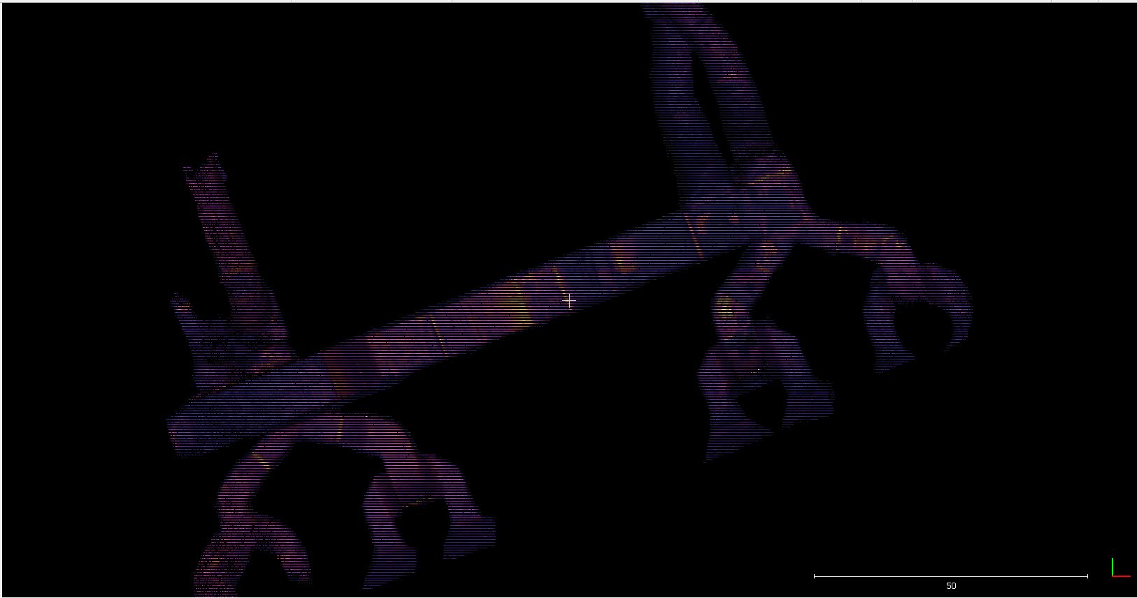

Hi Guys

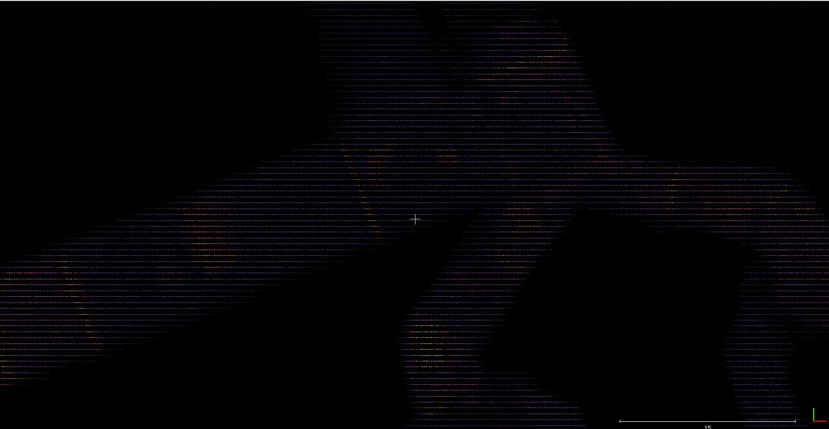

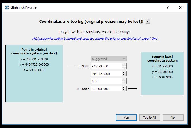

in the last recent versions I noticed a visualization problem with a lot of digits, like WGS UTM 84. In the past versions if I chose to applicate a Global shift/scale (coordinates are too big) the viewer of the points was correct. Now, the visualization is sliced like the attach photo. Is the same if I answer yes, yes to all or No

AFAIK it's an issue with the export of PLY files generated in Agisoft. Try using the shift settings when exporting from agisoft, that should solve the issue.
