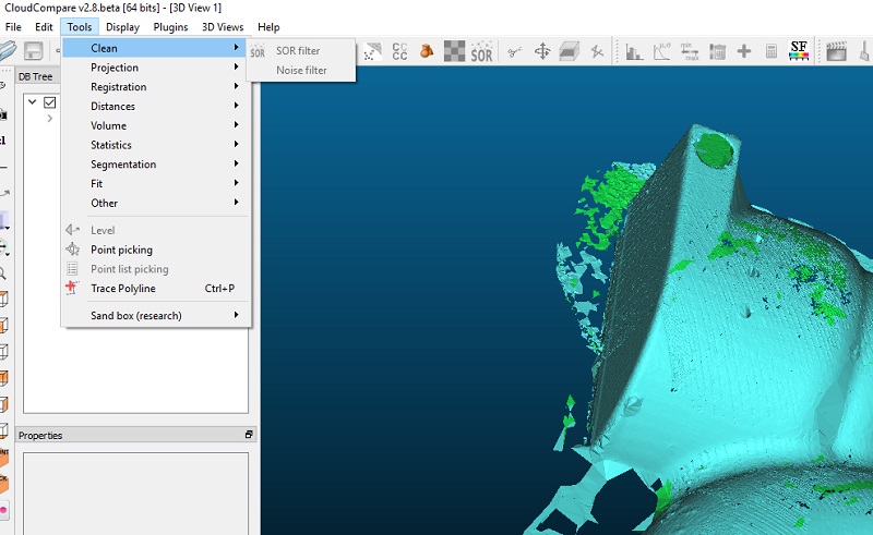

Hi I'm newbie obviously!
I would like to process a mesh from Kreon scanner, make it smooth for Reverse engineering, so not to lose too much accuracy.
Why are the options under Clean/SOR and Noise greyed out? And what settings would be best as to not lose too much detail, but smooth at the same time?

Because CC is not a 'mesh' tool so most of its methods are for point clouds :D.
But you could use the 'clean' methods on the vertices and try to remesh them afterwards (with Poisson). Or maybe take a look at options in Meshlab?

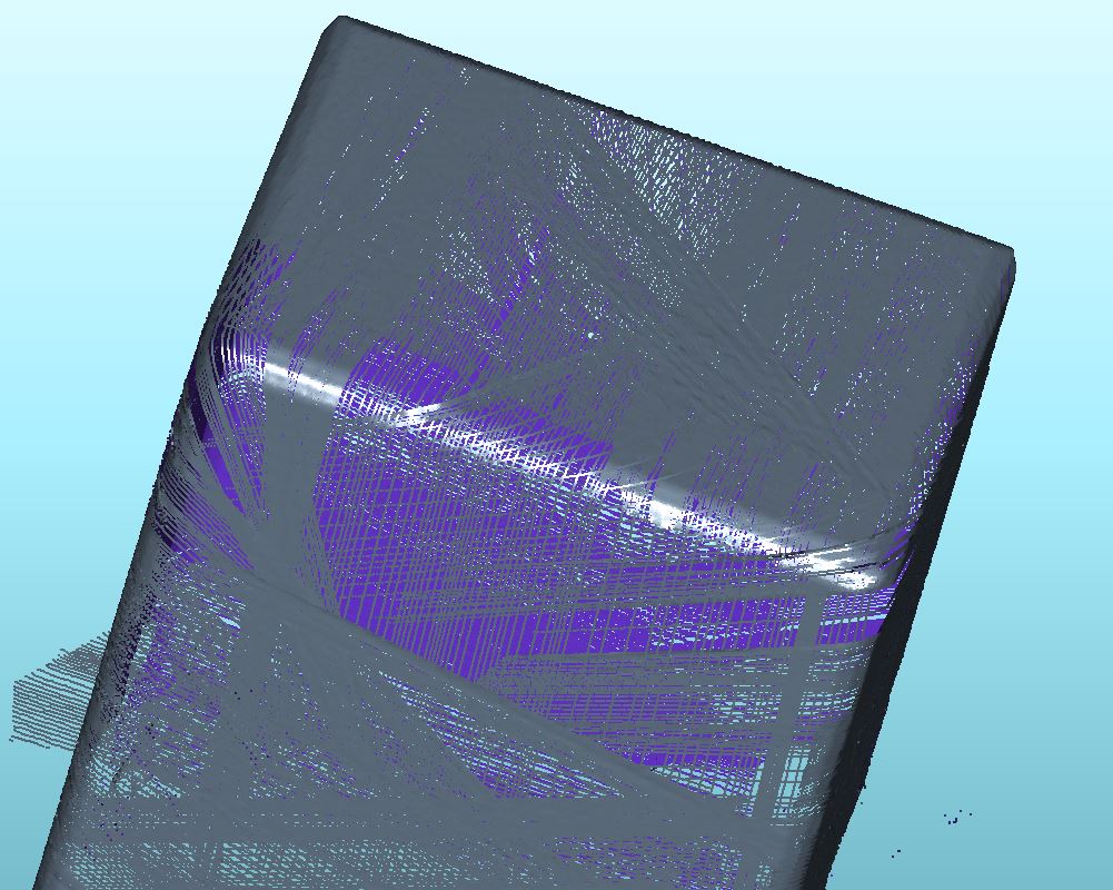

Thank you for your responses.
As far as I know, this is a point cloud directly from the scanner. I am using the scanner for reverse engineering, but I don't have Geomagic or Polyworks.I would like to be able to do an accurate clean up of the point cloud or mesh, so that I can use Rhino to cut sections and start surfacing from those.
For example, this attachment is a glass cube, so its scan should also be smooth, but its quite rough. How do I go from rough to smooth?
- Scan capture.JPG (149.57 KiB) Viewed 15447 times

I think Meshlab will be a better choice to work with the scan, since it gives some additional tools for generating a surface from a point cloud.
Unfortunately Meshlab is not an easy application to use. I find there's a lot of trial and error with the various settings and although there is some explanation with tooltips, sometimes I find I'm still guessing as to what values to enter.
I would not spend a lot of time trying to get a nice looking mesh. If you are creating new curves, you need only enough of the surface to use as a reference, so holes are OK. Reducing noise is helpful to some extent, but at some point you may loose the accuracy of the reference if the noise reduction is excessive.
I typically use Geomagic, and have used Meshlab occasionally.
