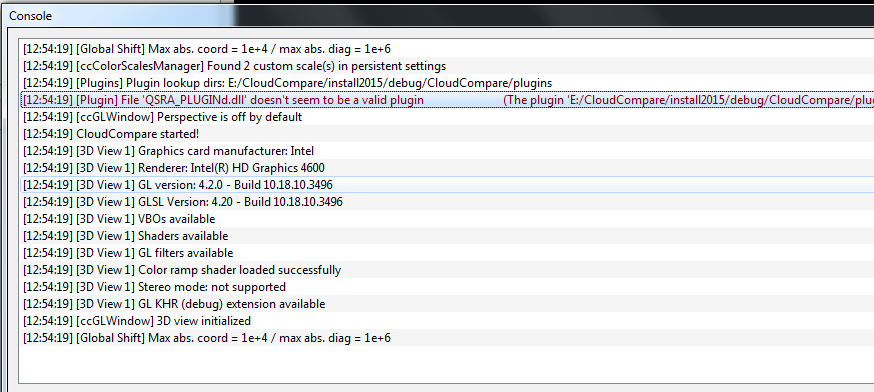

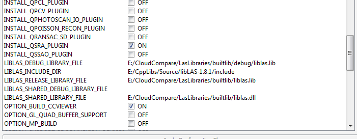

I built cc on Windows 7 using QtCreator(Qt 5.7.0 Msvc 2015 x64). Everything looked fine but I am not able to debug the plugins. In debug mode the plugins menu is disabled. As shown below, only QSRA plugin is enabled. Use_LIBLAS is OFF(i had doubt whether this was causing issue).
Any idea why this happens? When i look at the console, it has this message there.
Code: Select all
[12:54:19] [Plugin] File 'QSRA_PLUGINd.dll' doesn't seem to be a valid plugin	(The plugin 'E:/CloudCompare/install2015/debug/CloudCompare/plugins/QSRA_PLUGINd.dll' uses incompatible Qt library. (Cannot mix debug and release libraries.))

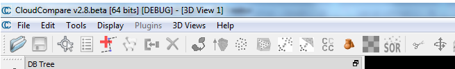

In the title bar of the main window, what do you read?

hi,
It is 2.8 beta as shown below. Anyway , I am getting around without debugging using old school logging.
thank you for the time.
Re: Debugging when plugins are enabled
I just wanted to make sure that the application was compiled in DEBUG mode... But this is puzzling, because it implies that the plugins are compiled in release mode?!
