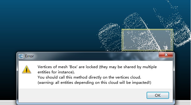

Hi, I am new to cloudcompare, and I want scale the box in the cloud point. But it pop-up an error like this:
Vertices of mesh 'Box' are locked (they may be shared by multiple entities for instance).
You should call this method directly on the vertices cloud.
(warning: all entities depending on this cloud will be impacted!)
How can I do to scale the box?

Where is this 'box' mesh coming form? Is it a box primitive?
Anyway you should indeed be able to select the 'vertices' entity that is below the mesh entity in the DB tree. Then apply the scaling on it.

Thanks Daniel,
Yes, the 'box' is box primitive add by my own cloudcompare plugin. Now I known why I can't scale the box directly select the 'box'. Thanks.
