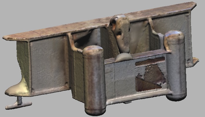

Once open in CloudCompare I have noticed plugin add mesh at space where was no points. To better visualise I am attaching rendering of this in Inventor.
Could you please advise how to get proper mesh on point cloud I am using? Kindly please advise any step...

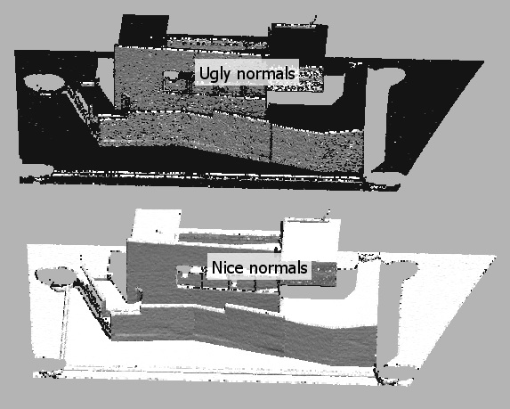

1. Here is what nice normals should look like:

And regarding your cloud: it's quite noisy so you'll have to denoise it a little bit first in order to get not-too-bad-normals (you can increase the points size to see the noise). You can use the SOR filter to do this (see 'Tools > Clean > SOR filter' - leave the default parameters). Then compute the normals and when asked about orienting the normals, say yes and use a low number of neighbors (3 for instance). Here's what you should see:
(note that it's not perfect yet, but it's hard to get a better result with a noisy and incomplete scan, especially on the front part where the two sides are very close and almost 'connected' due to the noise)

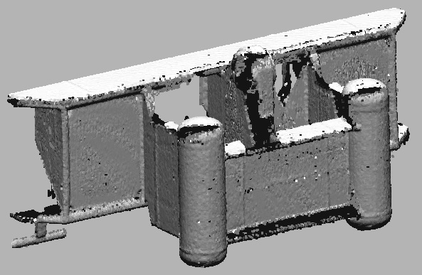

And here is the result with PoissonRecon:
You could use the density information to remove the bad parts (see http://www.cloudcompare.org/doc/wiki/in ... n_(plugin)). But it would be better to get rid of the noisy parts prior to use PoissonRecon (maybe with the scissors tool?). At least you should get the idea.

What more, do you have any procedures for cleaning and preparing normals for this?
All my scans are in similar quality, I just saw that SOR filter works really good, but cannot say the same about normals.
Each time those are "ugly black". Any recommednations in this ?
Re: CloudCompare mesh adds unwanted surface
Did you use the 'auto' button of the normals computation dialog? And if the normals are mostly black, then they may be simply globally inverted (use the 'Edit > Normals > Invert' method to invert them).

Certainly I did. Also I have tried with inverting.
The issue is there is always an area which has opposit black normals to the good ones... It is never coherent.
It's due to the noise that 'connects' the surfaces in weird ways and the orientation propagation fails...
Apart from playing with the 'number of neighbors' parameter of the normals orientation algorithm, you'll have to segment the cloud in multiple parts and compute the normals on each part and eventually merge those parts back together.
