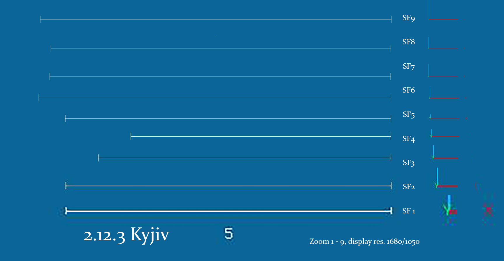

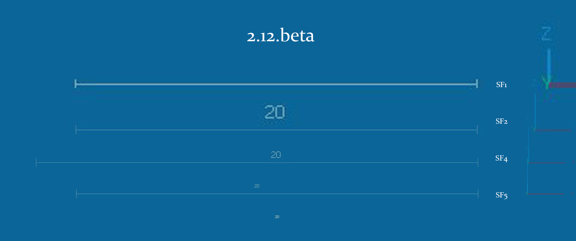

I have used v. 2.12.3 Kyjiv (zoom 1-9), now i tested 2.12 beta (zoom 1 and 4), the scales are not right. I have made a graphic comparation, but I don´t know how to post it here :)
Re: Scaling problem
You can normally upload images? (with the 'Attachments' tab below the main message field).
And you mean you have tested this with the 2.13.beta version I guess?

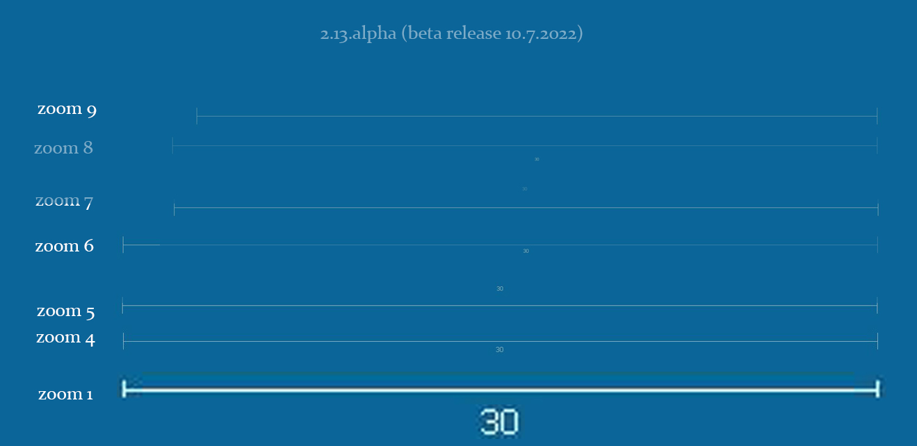

Sorry, I haven´t noticed, here are the pictures:
Even now, v.2.13.alpha (Latest beta release: 2.13.alpha (7/10/2022)) there is still scale distortion, begins with zoom 7. Zoom 1 to 6 is correct. To me, scale 6 is enough, but I don´t know about others, maybe just add warnings since zoom 7?
Thank You
Re: Scaling problem
Hum, that doesn't really make sense, but thanks for the feedback! I'll need to dig in deeper in the code to understand what happens...
