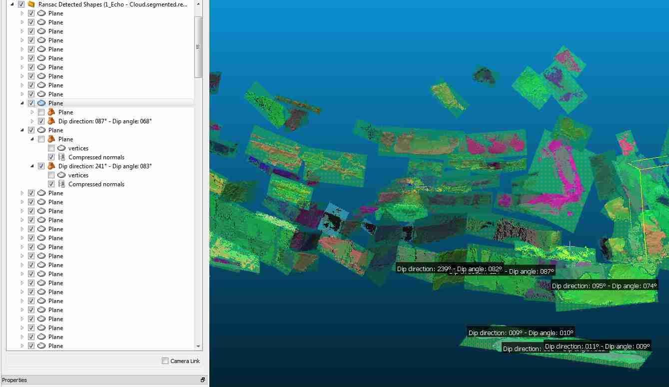

Hello Daniel,
first of all I want to thank you for this super piece of software and for your support. I use the software (Cloudcompare & the Ransac Shape Detection Plugin) for my master thesis in applied geology to detect rock faces in point clouds.
To my question: How can I export the "dip direction & dip angle" to a .txt-file or store the values in a scalar field?
Some details to my proceedings so far: I used the "Ransac Shape Detection" which gave me seperated pointcloud-classes and their planes. On these data I used "Tools/Fit/Plane" to get another plane, which has the "dip direction & dip angle" in its "name-field". As I cannot import the planes to other availible software, I want to export the values in a .txt file or in a scalarfield.
I used a "Riegl TLS" and "Riscan Pro" for scanning and data registration. Further proceedings I did all in Cloudcompare.

- Result of Ransac Shape Detection
- Ransac Detected Shapes_s.jpg (63.24 KiB) Viewed 24319 times

Is such a change/adjustment of the code even possible?
the code is working fine and we appreciate your work.
Is it further possible to export not only the dip and surface of the planes, but also the vertices/contours? If ceating a plane, Ive got 4 corner points...or if creating polygons I got a lot of vertices... It would be nice to able to save all these information easily to a .txt-file additionally to the dip/dip direction. I already tried to adjust the code...but havent been succesful yet.
Re: Export Dip direction - Dip angle from planes
Well,
If you want to save the vertices of the plane or the polygon, you can do something like that:
I assume you know how to open a new text file. For each valid entity (i.e. in the 'if (cloud)' block), use the same code as before but with another name. Typically something with an increasing index:
This will create one file per entity next to CC's executable. Let's assume also that the stream for each file is named 'vertStream'.
If you have a plane: (i.e. in the 'if (pPlane)' block)
If you have a 'facet', you can use the same code but the vertices cloud is fetched differently:
If you have issues with this, don't hesitate to send me your 'mainwindow.cpp' file.

JonaRaimat
- Posts: 1
- Joined: Thu Feb 25, 2021 7:45 pm
Hello Daniel, hello everyone,
First I'm new in the forum, I work some times with Cloudcompare and I see this post and really is a good job.
I want to ask if somebody try to update the ransac pugin with this code to export dip and dip direction.
I was trying to compute cloudcompare with CMake and I have some problems.
KR
KR
