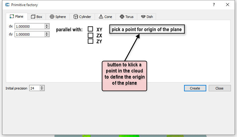

Is it possible to change the command "Plane" in "Primitive factory" like on my picture? That would be much more easyer and faster.
changed command plane.jpg (42.16 KiB) Viewed 6129 times
Re: Plane parallel with ZX
The 2.8 beta version has now a 'Edit > Plane > Create' method that lets you do this.
