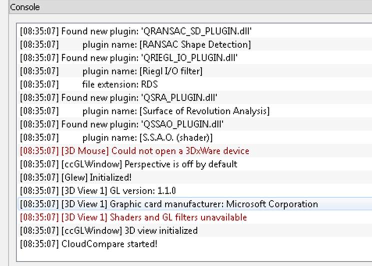

when I log in via remote connection to my computer at work CC 2.7 does not start (as mentioned). I can also confirm (as others mentioned in other posts) that if I launch CC 2.7 directly from work it works fine, and I can see it from remote too - but I cannot launch it from remote. If I launch CC 2.6.2 from remote it shows the following Console ...

- CC_console_remote.jpg (62.81 KiB) Viewed 24123 times

I tried both, Intel and NVidia (at least I registered CC in NVidia Control Panel).
And I failed to find 2.6.2 in 64 bits. Is it available?

Re: 2.7 with windows 10 dosn't start
I re-uploaded the 2.6.3.beta version (the latest version before the migration to Qt 5):
Installer: http://www.cloudcompare.org/release/Clo ... up_x64.exe
Archive: http://www.cloudcompare.org/release/Clo ... bin_x64.7z
Daniel,
Solution was in setting NVIDIA as default graphics processor (or selecting NVIDIA if run / Run with graphic processor and selecting NVIDIA).
Encountered same with MeshLab, found this solution there, thought it might be same with CloudCompare - and it is working.
There should be a way to check this upon start and at least report problem to the user.
