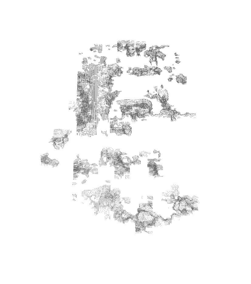

Not sure to understand. Do you have a 'volume' point cloud? Can you show me what your cloud looks like once you have applied the SF threshold?

so I have been working on the subject. The isosurface is the equivalent of topographic contour lines for volumes.
My first problem was that the volume that I generated using the SF filer was full of points, so I applied another filter in order to generate the shell (see in attachment). The problem now is that shell has interruptions or holes and the creation of the equivalent surface i complicated using 3D software. So I contacted the support of the software I used to create the data and they told me that I could already export the isosurface from the program.
The format is an ASCII file with at each line the XYZ coordinates of the vertexes of each triangle of the isosurface. Is it a format I can open with cloudcompare? I tried to import it as stl but the coordinates of the points are negative. Shifting the coordinates to positive values is enough? Is there another format I could use?

- SF-filter.png (37.89 KiB) Viewed 13028 times

Do you have only the vertices in the file? Isn't there something else to describe the triangles? Could be an OFF file in this case.
