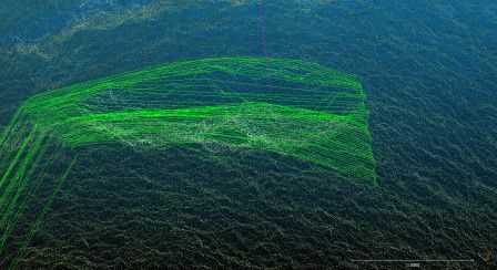

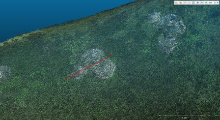

On the screen is the point cloud and the scaler field of my model. The model has intential pot holes, buldges and cuts in it. What I want to do, is draw a polyline across one of the pot holes and contor the hole. Firstly in the X_Y plane then the X-Z plane, making me a polyline image which I can then export the contor lines to CAD and produce a drawing from them.
I have got as far as adding the polyline X-Y, X-Z but everytime I do it i get stuck. The lines are always long and dont stop just at the edges of the pot hole they go all the way round the model and backagain. This I have been tearing my hair out about. Havn't got to the point to export anything yet.
Please see a few screen grabs of what I trying to explain.
Polyline across pot hole_5.jpg (47.08 KiB) Viewed 10882 times
Polyline across pot hole_1.jpg (43.39 KiB) Viewed 10882 times
At the end of the day, I need to take all these imperfections and produce drawings for them all. Is it possible the whay I am doing it? Or is there an easier way?
Many thanks for any comments on the above.
Chris.
Re: Polylines across point cloud
Do you have points 'below' the hole? I guess CC consider that some points quite far away from your holes as being part of the 'section'.
You should try to segment out the hole first. Use the scissors tool (http://www.cloudcompare.org/doc/wiki/in ... ation_Tool) to isolate the area you want to extract the contour from. I guess things should go easier then.
