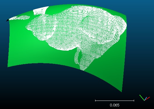

So far:
2.6.1 :
Code: Select all
[09:31:42] [doActionFitQuadric] Quadric equation: z = 0.191049 + 3.54679e-05 * x + 0.00128381 * y + -0.00411162 * x^2 + 0.00332104 * x.y + -0.000473885 * y^2
2.6.2.beta:
Code: Select all
[09:31:28] [doActionFitQuadric] Quadric equation: z = 0.467229 + 3.54679e-05 * x + 0.00128381 * y + -0.00411162 * x^2 + 0.00332104 * x.y + -0.000473885 * y^2
the "x.y" bug is still present (if it is a bug...)
There is little to no difference in the two produced clouds since the only thing that is changing is the constant parameter, that is the "new" cloud is only slightly higher but still doesn't fit.

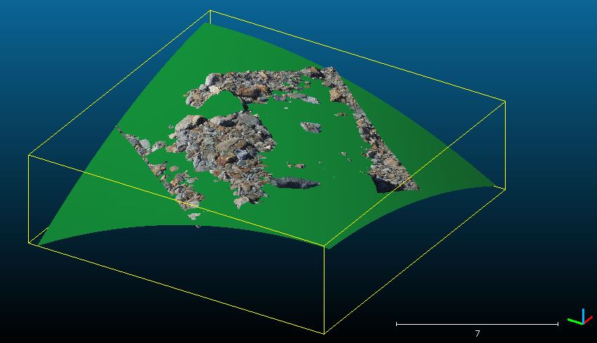

matt_w
Posts: 5
Joined: Sun Dec 01, 2013 11:34 am
Re: Flattening of a 2D surface
Post by matt_w »
Hi guys,
I've stumbled on this thread whilst trying to do the same thing, but I'm afraid that you lost me about halfway through with the technicalities of it all.
Put simply, I'd like to detrend my point cloud using the quadric (below) before running some basic stats on it, e.g. detrended standard deviation of elevations, etc. I've already fitted a standard plane and oriented the data so that this plane fits the x,y dimension of the data (as advised), but I'm struggling to figure out how to then use the quadric equation/transformation to manipulate the point cloud to essentially remove the quadric curve signal.
Would you be able to explain the steps in a simple way, please?
Many thanks, keep up the good work.
Well, you may try this trick:
- compute the distances between your point cloud and the quadric (Tools > Distances > Cloud to Mesh)
- then convert the output 'C2M Distances' scalar field into the Z coordinate of the cloud (Edit > Scalar fields > Set SF as coordinates)
THERE'S A BIG APPROXIMATION CONCERNING X AND Y (they should be displaced as well). If your quadric is too curvy, then the distortion will be high.
It will also be slightly approximated because the quadric mesh is tessellated. But it's less severe and you can increase the quadric 'drawing precision' before computing the distances to increase the accuracy (depending on how important it is for your application).
P.S.: once done, you can remove the scalar field (or simply restore the RGB colors as the default color source).
