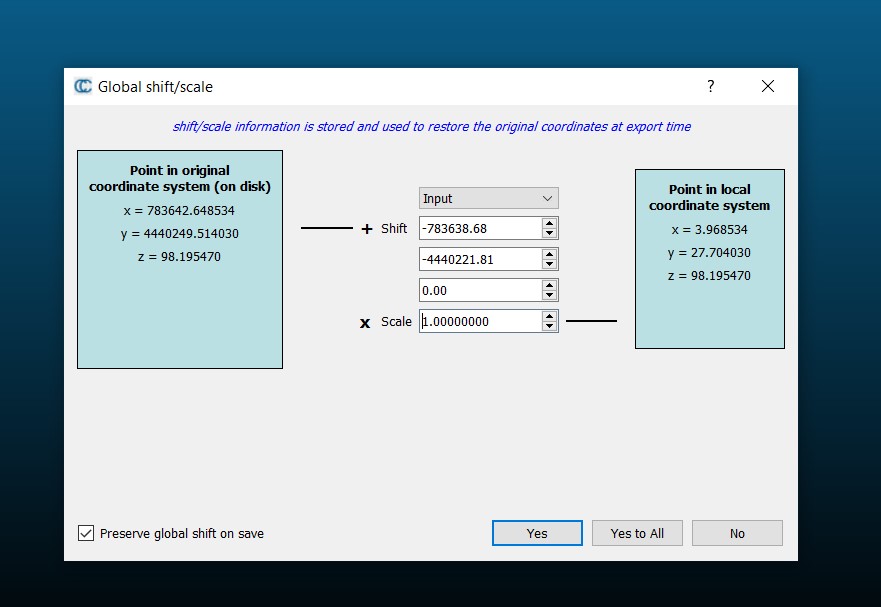

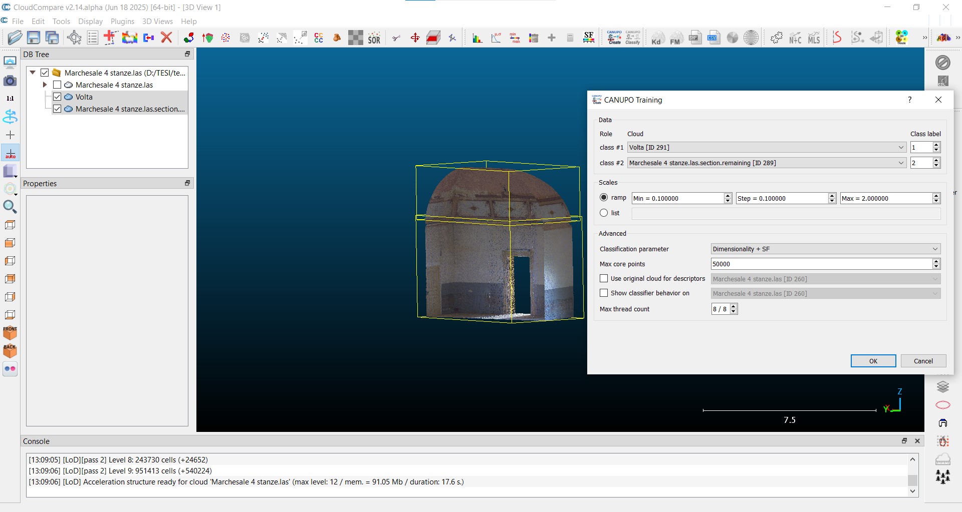

I tried with 2.13.2 Kharkiv (08/07/2024) and now I'm trying with the latest version 2.14.alpha (18/06/2025). But even when I start training the classifier, Cloud Compare starts lagging and doesn't work. Attached are screenshots of the global shift/scale and trainer setup. Am I doing something wrong? I am trying to train the classifier to automatically classify the slab from the rest of the elements such as floor, walls etc.

I've tried on my side (with a random test dataset that I used in the past) and it still works properly with the latest 2.14.alpha version.
Things to pay attention to:
- you have a lot of scales (about 20) and the largest ones span over what looks like a third or half of the cloud width (which means it will encompass a lot of points, and therefore take a lot of time to compute)
- you may want to lower the max thread count (to 6 or 7) so that your PC keeps responding during the computation. I guess what happens is that the computation takes a very long time, and what you perceive as 'stop working' is that the processor is too busy.
If you think it's something else, don't hesitate to share your clouds with me ([email protected])
