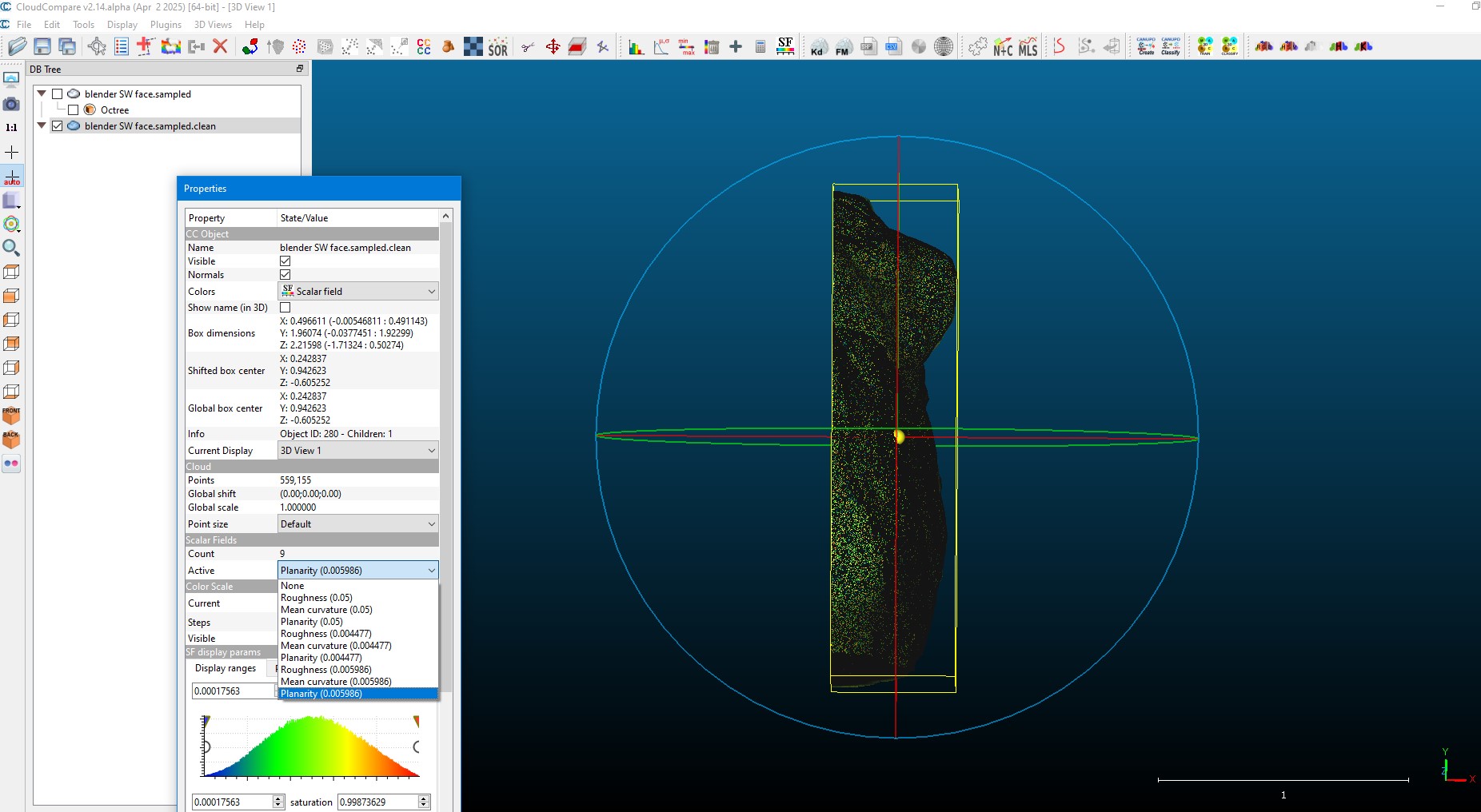

I've been trying to analyze various surfaces of a large (3 M) boulder (1,000,037 points) for planarity, mean curvature, and roughness.
I've sampled the photogrammetry file to convert it to a point cloud and have segmented the desired surfaces for individual analysis.
I use the Tools/Other/Compute Geometric features and no matter what neighborhood radius number I use, all three calculated parameters come up with the same number as the neighborhood radius.
I've run this process dozens of times now using the default-suggested value, inputting values ranging all the way from 0.0001 to 0.5, and no matter what value I use for the neighborhood radius, the results for planarity, mean curvature, and roughness all return the same number as the neighborhood radius. What am I doing wrong??
SW face all calcs the same.jpg (254.34 KiB) Viewed 8490 times

Can you maybe send me a sample point cloud? (to '[email protected])
And also the set of parameters (radius values) you've tried?

I've forwarded a dropbox link to the files. The file size was too large for an email.

I've modified the slices to be a uniform 1 m² on each face (1.8m tall x 0.833 wide)
Re: All geometric features coming up only with neighborhood radius value
Thanks, I've received the data and replied to your email.
And for the records, the resulting scalar fields were different, but the initial confusion came from the GUI...
