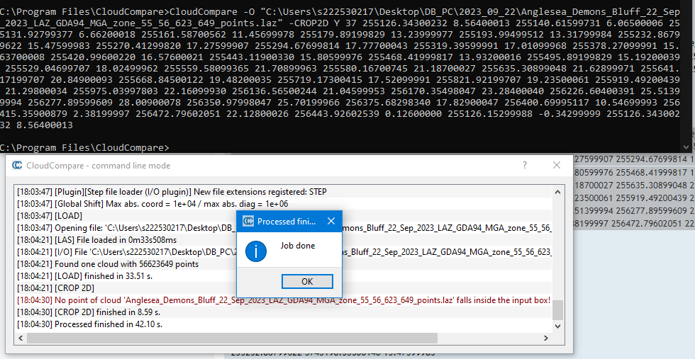

I am having some issues with crop2D. For some reason I can crop on the Z-axis without problems (examples below), however, when I try to crop on the y axis, I get the error "No point of cloud ___ falls inside the input box".

Here is the command I am having problems with
CloudCompare -O "C:\Users\s222530217\Desktop\DB_PC\2023_09_22\Anglesea_Demons_Bluff_22_Sep_2023_LAZ_GDA94_MGA_zone_55_56_623_649_points.laz" -CROP2D Y 37 255126.34300232 8.56400013 255140.61599731 6.06500006 255131.92799377 6.66200018 255161.58700562 11.45699978 255179.89199829 13.23999977 255193.99499512 13.31799984 255232.86799622 15.47599983 255270.41299820 17.27599907 255294.67699814 17.77700043 255319.39599991 17.01099968 255378.27099991 15.63700008 255420.99600220 16.57600021 255443.11900330 15.80599976 255468.41999817 13.93200016 255495.89199829 15.19200039 255529.04699707 18.02499962 255559.58099365 21.70899963 255580.16700745 21.18700027 255635.30899048 21.62899971 255641.17199707 20.84900093 255668.84500122 19.48200035 255719.17300415 17.52099991 255821.92199707 19.23500061 255919.49200439 21.29800034 255975.03997803 22.16099930 256136.56500244 21.04599953 256170.35498047 23.28400040 256226.60400391 25.51399994 256277.89599609 28.00900078 256350.97998047 25.70199966 256375.68298340 17.82900047 256400.69995117 10.54699993 256415.35900879 2.38199997 256472.79602051 22.12800026 256443.92602539 0.12600000 255126.15299988 -0.34299999 255126.34300232 8.56400013

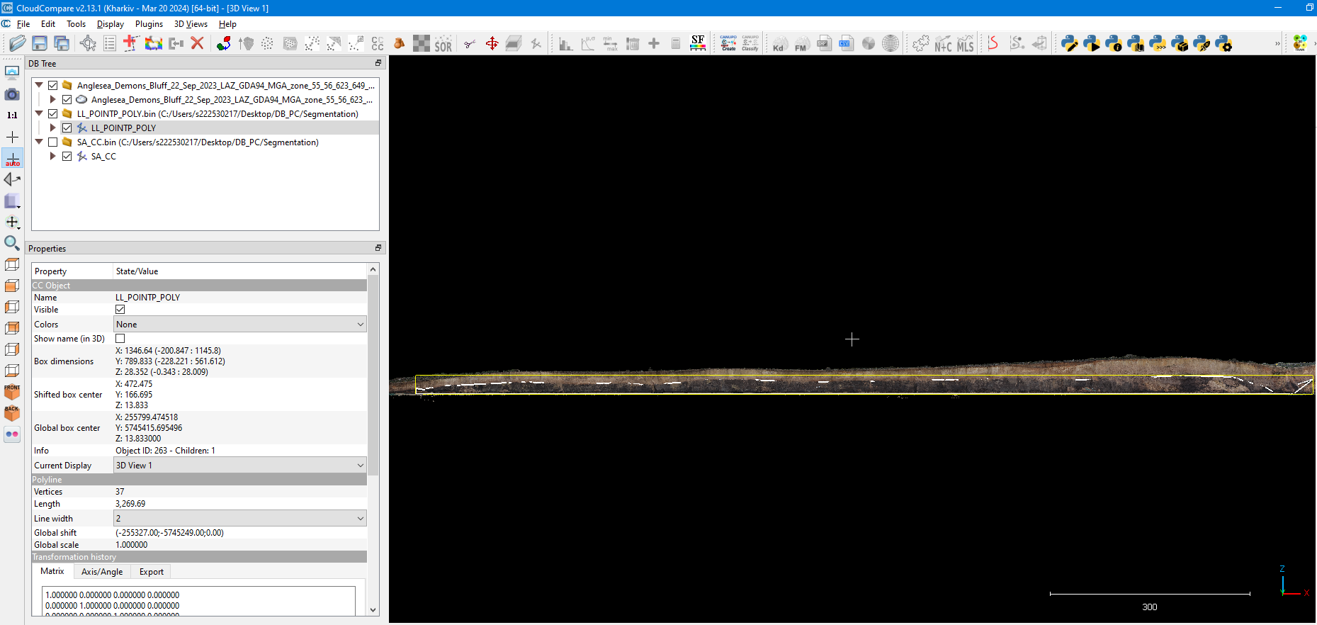

Here are the vertices of my most recent polyline, created by point-picking

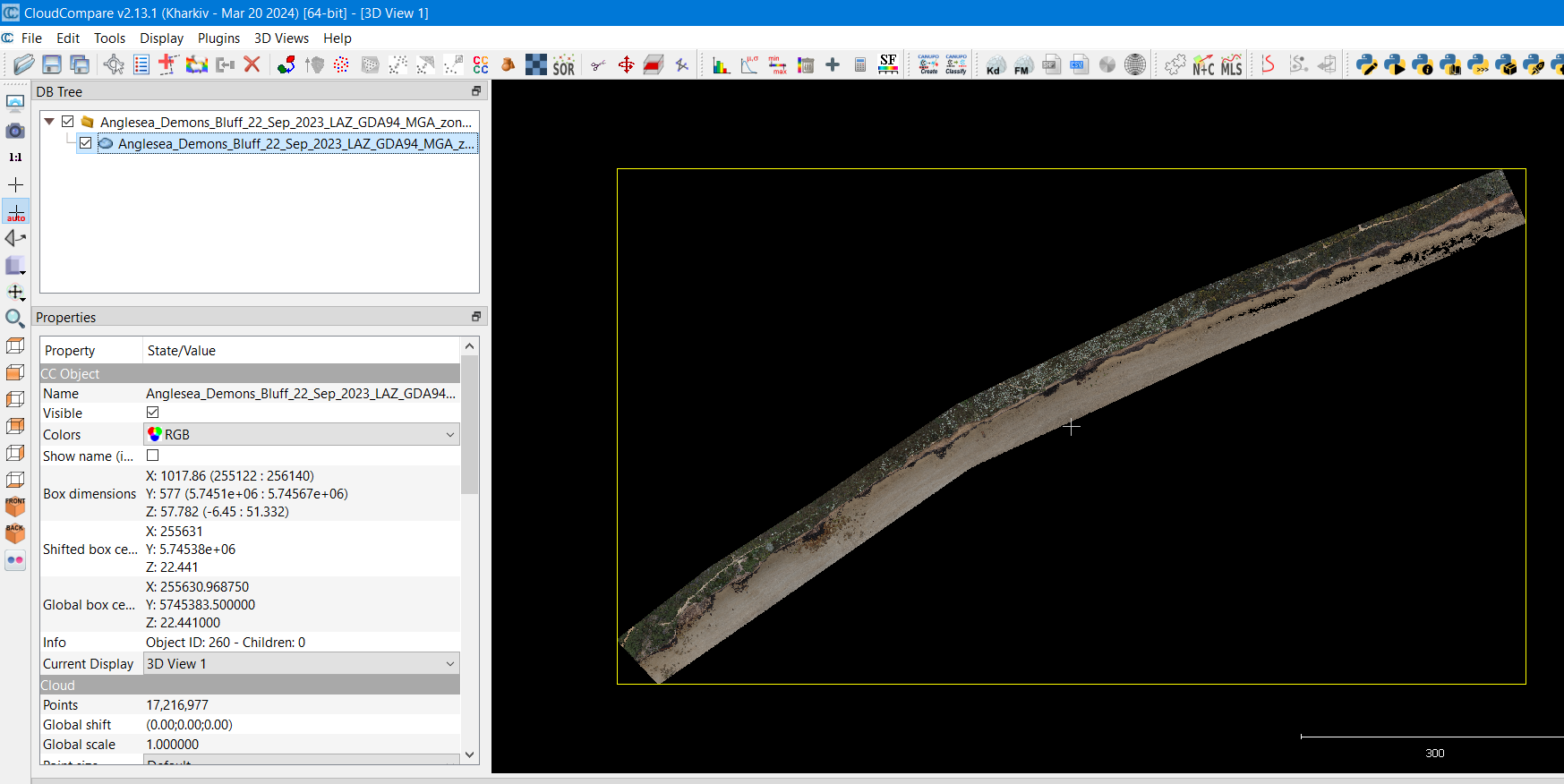

Whole cloud
Whole cloud.PNG (172.87 KiB) Viewed 16999 times

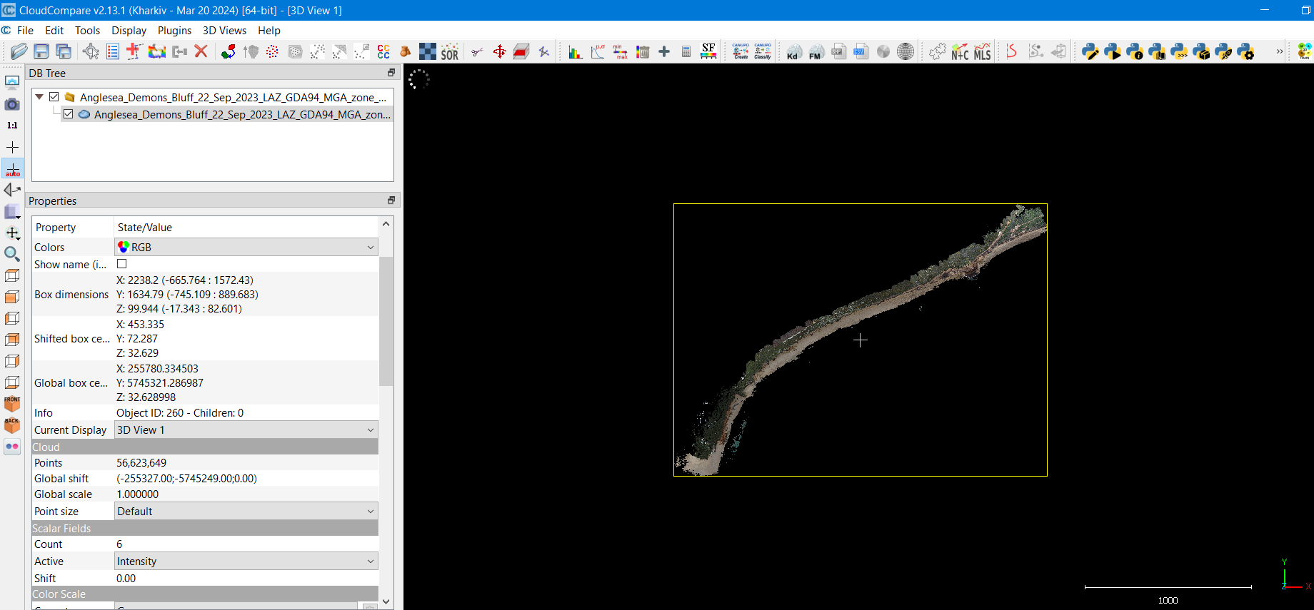

Cropped cloud - Z axis
cropped cloud.PNG (333.34 KiB) Viewed 16999 times

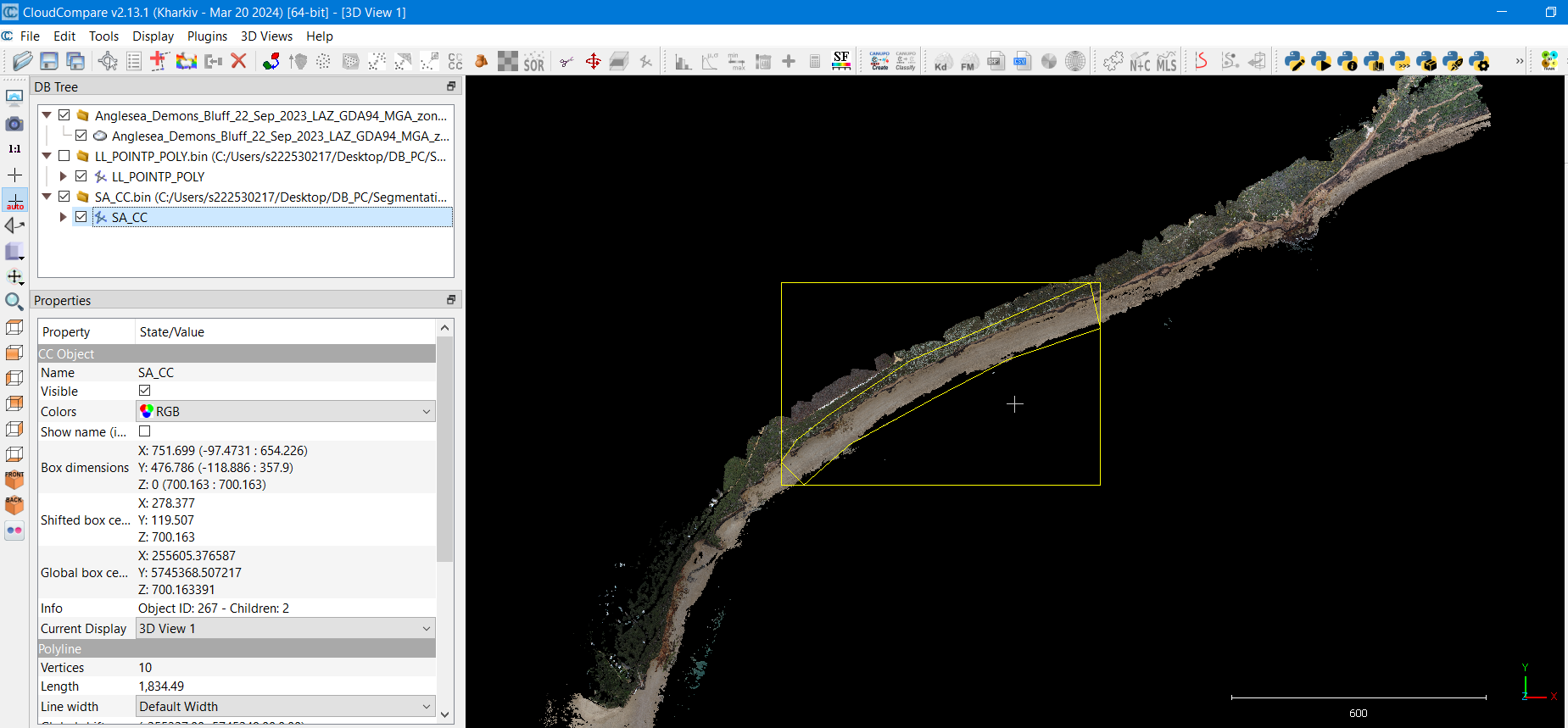

Successful crop polyline
Succesful crop.PNG (382.98 KiB) Viewed 16999 times
Unsuccessful crop polyline
Failed crop_pointpicked.PNG (235.81 KiB) Viewed 16999 times
Error

Is it related to the Global Shift maybe? Normally, you should handle it in the command line mode as well (with '-O GLOBAL_SHIFT AUTO' or another option). If you don't, the digits of the large coordinates are truncated and this may mess with the crop tool as well?
If it's still behaving the same, would you mind sending me the cloud you used with the Y direction? (to [email protected])
Re: Crop2D - Only working on one axis
Thanks for the data. It helped me understand why it didn't work on your side.
First, if you apply a Global Shift at loading time (which is mandatory for keeping the data accuracy), the coordinates of the polyline vertices should be expressed in the local/shifted coordinate system! I realize it can be cumbersome, therefore I added a -GLOBAL_SHIFT option (similar as the one after -O) to apply the same Global Shift to the vertices as to the point cloud.
Then, something that was not explained in the wiki: if you set the Y dimension, CloudCompare expects the coordinates of the 2D points to be 'Z, X' and not 'X, Z'... That was tricky.
Once again, I added 3 new options to set the dimensions: Xflip, Yflip, Zflip (to invert what CC expects, and let you keep the coordinates as you've wrote them).
You can test this new version here: https://www.cloudcompare.org/release/Cl ... up_x64.exe
See the updated wiki as well: https://www.cloudcompare.org/doc/wiki/i ... _line_mode
And last, your command line should now look like:
Code: Select all
CloudCompare -O -GLOBAL_SHIFT -255327.00 -5745249.00 0 Anglesea_Demons_Bluff_22_Sep_2023_LAZ_GDA94_MGA_zone_55_56_623_649_points.laz -CROP2D Yflip -GLOBAL_SHIFT FIRST 37 255126.34300232 8.56400013 255140.61599731 6.06500006 255131.92799377 6.66200018 255161.58700562 11.45699978 255179.89199829 13.23999977 255193.99499512 13.31799984 255232.86799622 15.47599983 255270.41299820 17.27599907 255294.67699814 17.77700043 255319.39599991 17.01099968 255378.27099991 15.63700008 255420.99600220 16.57600021 255443.11900330 15.80599976 255468.41999817 13.93200016 255495.89199829 15.19200039 255529.04699707 18.02499962 255559.58099365 21.70899963 255580.16700745 21.18700027 255635.30899048 21.62899971 255641.17199707 20.84900093 255668.84500122 19.48200035 255719.17300415 17.52099991 255821.92199707 19.23500061 255919.49200439 21.29800034 255975.03997803 22.16099930 256136.56500244 21.04599953 256170.35498047 23.28400040 256226.60400391 25.51399994 256277.89599609 28.00900078 256350.97998047 25.70199966 256375.68298340 17.82900047 256400.69995117 10.54699993 256415.35900879 2.38199997 256472.79602051 22.12800026 256443.92602539 0.12600000 255126.15299988 -0.34299999 255126.34300232 8.56400013
