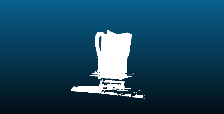

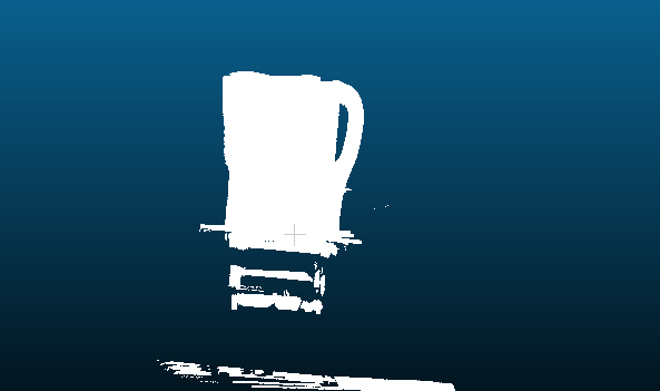

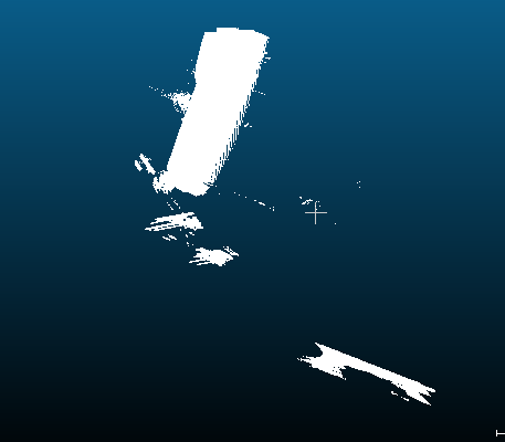

Daniel, I'm going to share the images I got from a test I did, they have a front, side and back view and what I wanted was to learn how to fill in the back, instead of it being the way it is.
From The sides.png (6.27 KiB) Viewed 5610 times

Well, it's hard to see (don't hesitate to activate the EDL shader ;), but assuming you have some overlapping surfaces, you can indeed use the Edit > Translate/Rotate tool to roughly align the scans, and then use the ICP tool (see https://www.cloudcompare.org/doc/wiki/i ... gistration)
