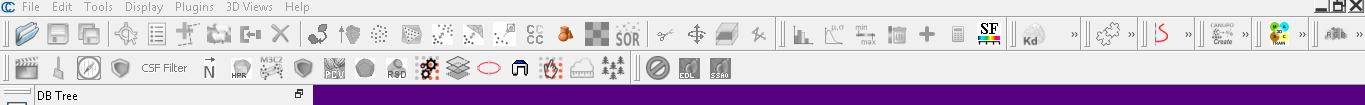

With version 2.13.1 the python 3DFin plugin does not install, is there another way to enable it?
Re: 3DFin
The 3DFin plugin is accessible via the 'Python plugin', so you have to go to 'Plugin > Python plugin > Plugins > 3D Forest Inventory'
