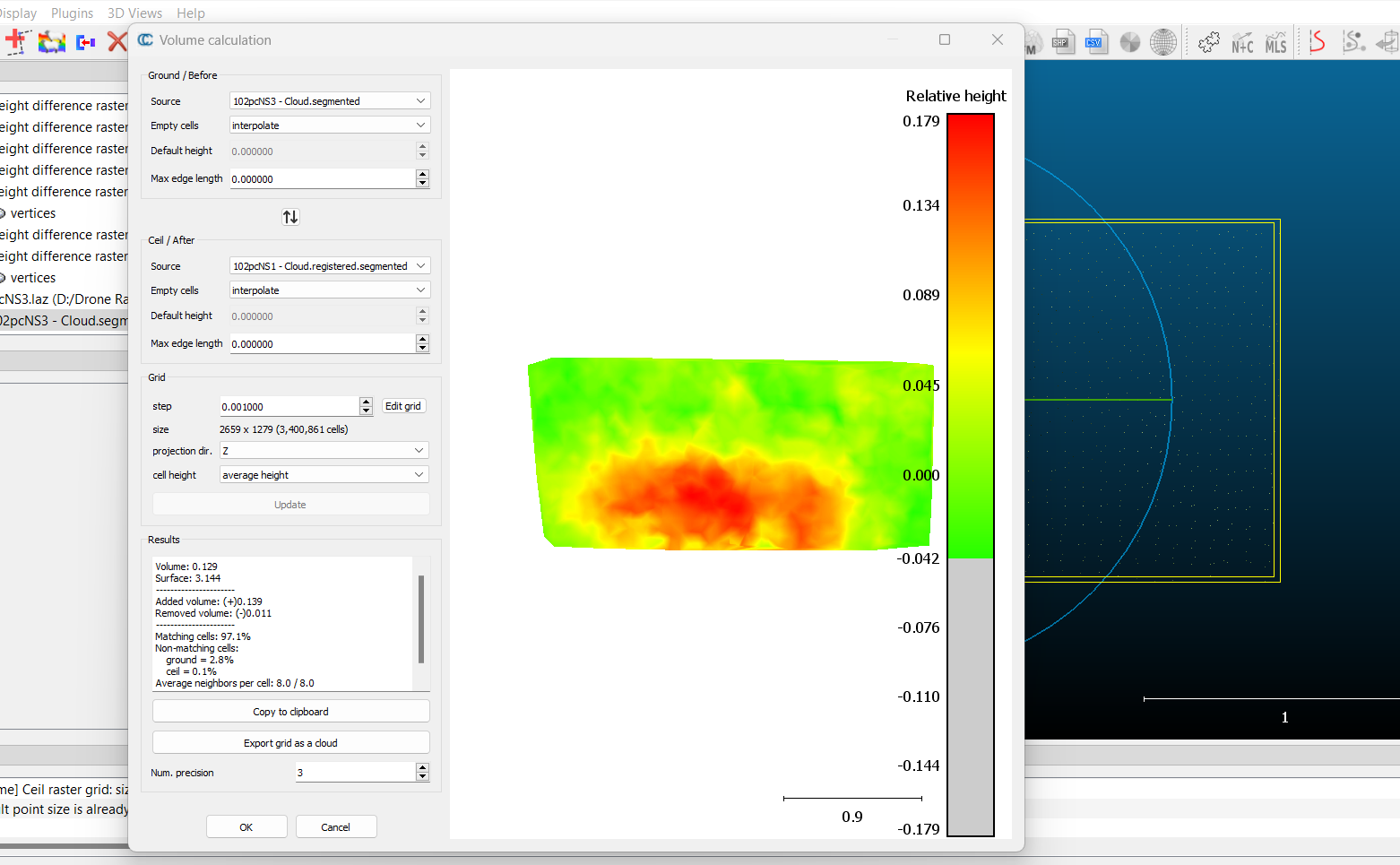

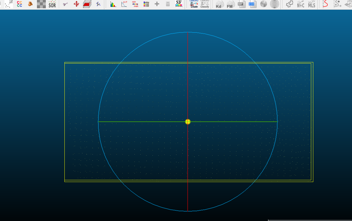

Ok, so, I'll try to explain better. I have two point clouds, one represents my plot of soybeans before cutting, and the other after having cut 6ft of soybeans, I'm trying to calculate the volume of this "hole" (part in red in the image) left by the cut comparing the two clouds, however with the volume tool, the exported cloud is the height difference tool, the tool only gives the volume value in the box, I'm trying to export the volume information to Excel, or another program. I transformed this height cloud into a raster and imported it into Qgis to calculate the volume, but I'm also unsure about the size of the step, how did you choose the value of this parameter? And how did you get the final volume information? I have 2,000 clouds to calculate.
Another thing that is weird is that the relative height scalar says the red part is 18, maybe centimeters, compared to the ground, but the soybeans were bigger than this.

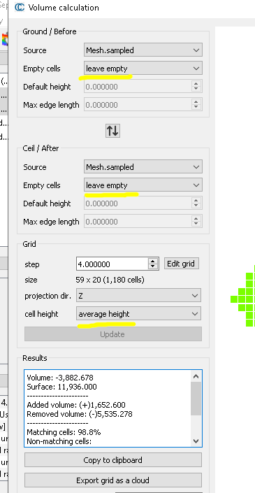

Use leave it empty otherwise you can get wrong results

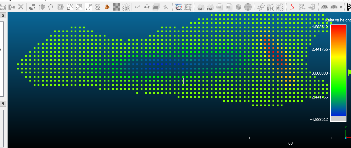

Start with small grid then increase until shape of grid is regular and volume is stable
.. This is OK

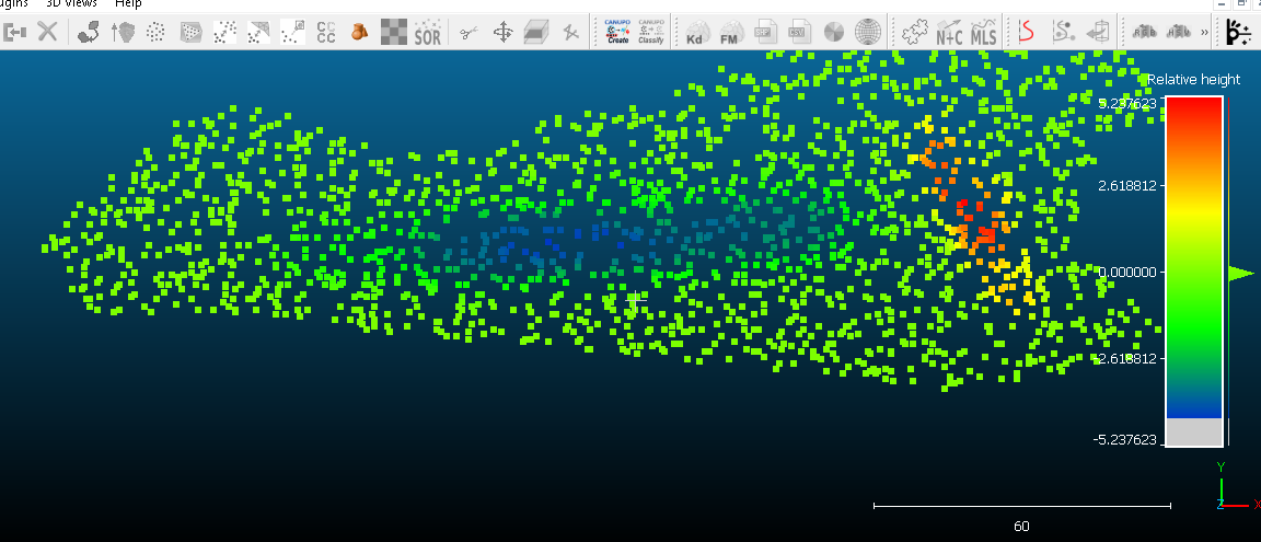

This is not OK because alot of holes , grid is too small compared to cloud density
You can check attached file for easy testing
