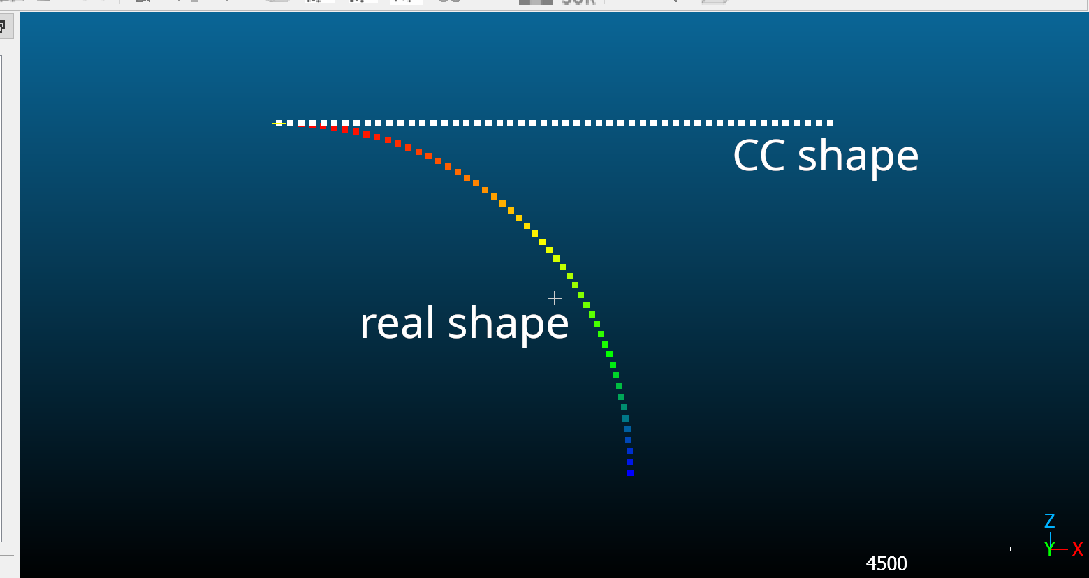

Suppose a ship travels inline with equator for a distance of 10000 km (earth circumference/4).
If z=0 y=0 and x from 0 to 10000 km
GPS coordinates are xyz in meters( UTM) and z is referenced to sea level which the same of earth curvature
CC represents track in straight line not curve
Can GDAL or other software prepare UTM to be represented in CC in real shape ?

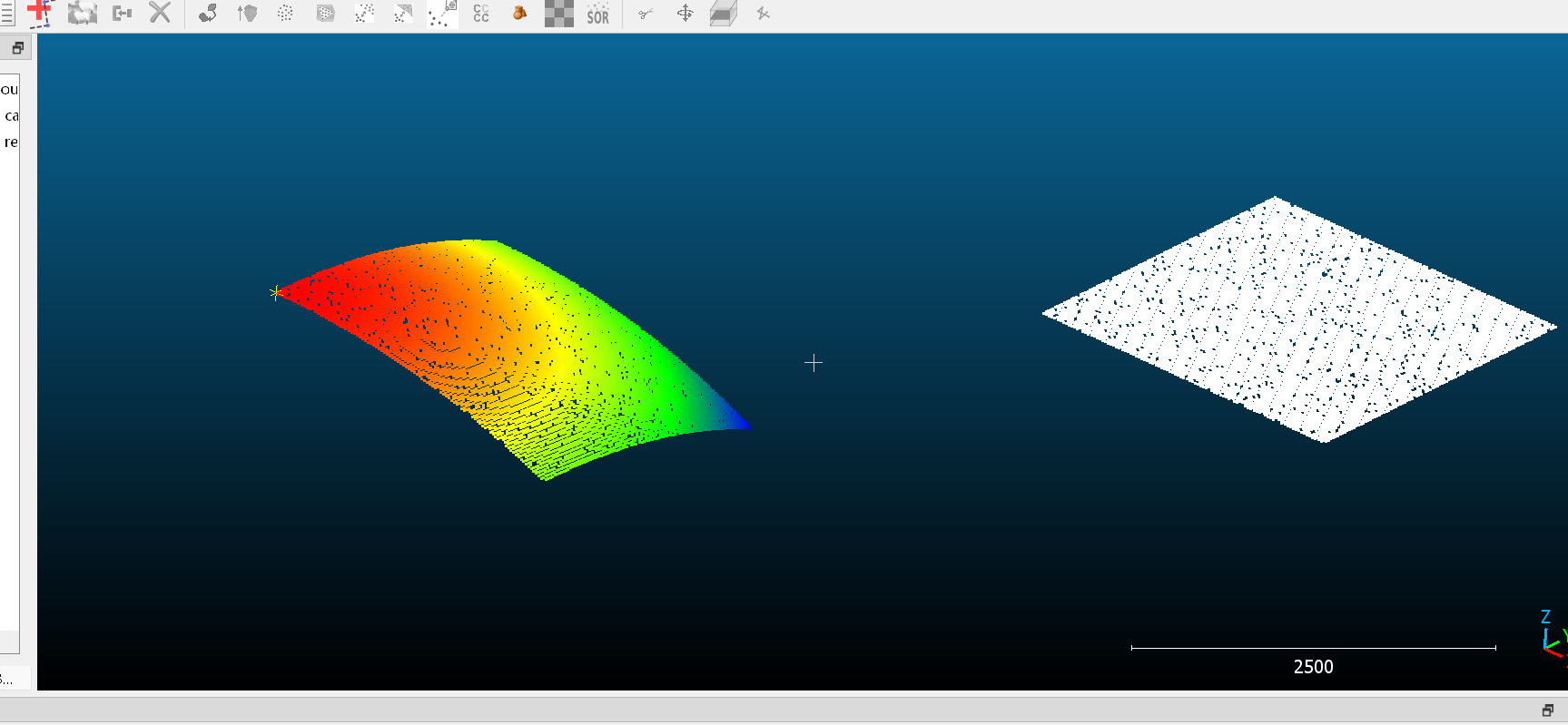

attached 3D pointscloud example
Screenshot (146).png (79.51 KiB) Viewed 18396 times
check CC file below

Let have these UTM coordinates (xyz in m) from a ship GPS log
x,y,z
468286,4082477,0
467995,3981250,0
467704,3880024,0
467413,3778797,0
467121,3677571,0
466830,3576345,0
466539,3475118,0
466248,3373892,0
465957,3272665,0
465665,3171439,0
465374,3070213,0
465083,2968986,0
464792,2867760,0
464501,2766533,0
464209,2665307,0
463918,2564081,0
463627,2462854,0
463336,2361628,0
463044,2260401,0
462753,2159175,0
462462,2057949,0
The real shape of ship track is ARC not straight line because earth curvature
GPS use z referenced to sea level (curved )
Because CC uses Cartesian coordinates ,it shows as straight line not curve line
Is there any existing software,lib which prepares utm to Cartesian so CC can show real curved line ? GDAL ?
