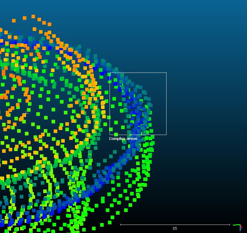

I think the biggest issue is with the cloud topology/organisation in the outer ring area: Looking at these points closely, I understand why the algorithm cannot find how to fit a single surface through all these points. Moreover, the estimation of the normals with so few points may not be super robust...
In your procedure, I would just change the 'normal orientation' method to 'Use preferred orientation' = 'From barycenter'. It's much faster, and is probably a little bit more accurate as it will consider the shape as a kind of sphere (instead of trying to deduce the local surface orientation based on the neighbors which are a bit messy in some areas). Apart from that very small improvement, it will be hard to avoid the various issues you spotted with such a cloud. You can maybe remove some of the points (with the Scissors tool) if you are able to understand which ones are causing these artifacts (especially the hook).

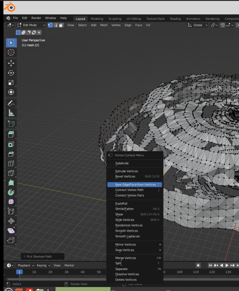

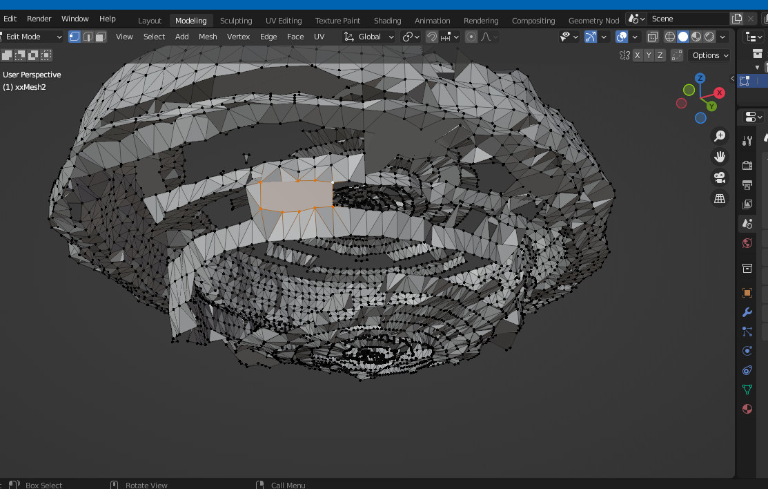

There is no automatic and easy way to build the mesh for this difficult pointscloud
I tried Meshlab then auto-fill holes with Blender
You can manually use face creation in Blender to complete the mesh
later, you can merge or delete any point (hook points) with Blender

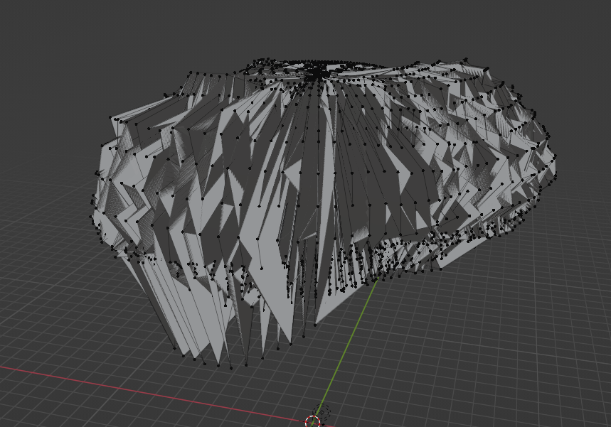

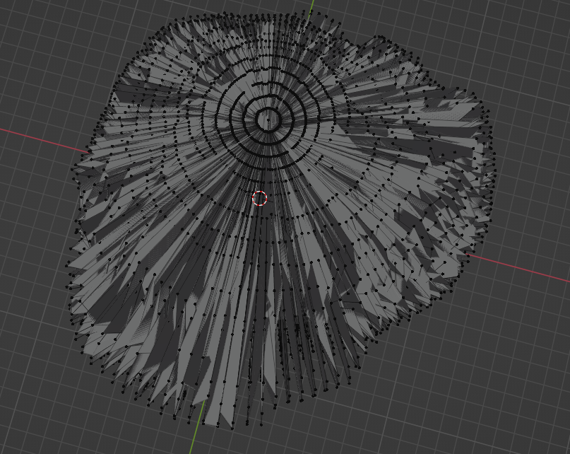

My apologies, I'm new to Blender. When I try to use the face tool or fill tool, I get the result shown in my attached images.
I've searched for advice on creating a mesh from vertices, but none have got me results like you show in your last screen shot. Could you offer any further tips?
Thank you so much.

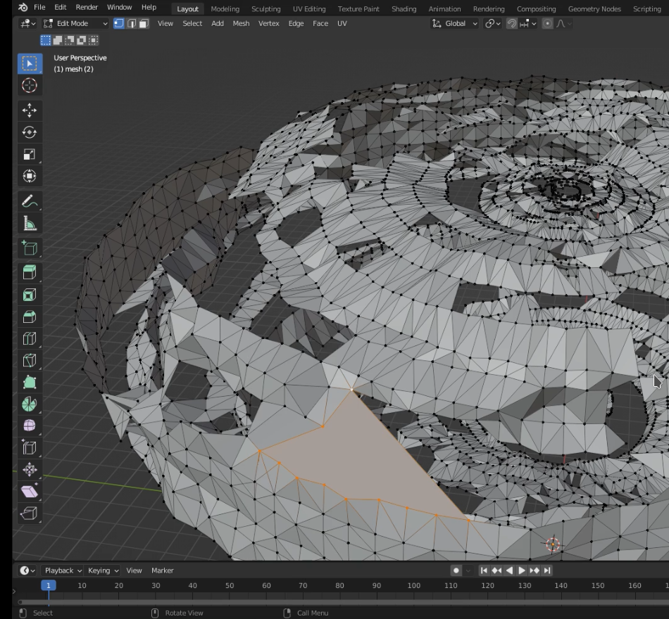

Steps are
import stl in MESHLAB
filter menu
re meshing
surface reconstruction
export to stl
in BLENDER
import stl
change to edit mode
aa to select all
mesh --- clean up -- fill holes (sides =0)
For manual holes filling
click multiple vertices+ ctrl one by one ---mouse wright click -- new edge/face from vertices
check attached vid in zip file
