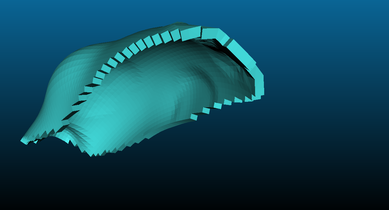

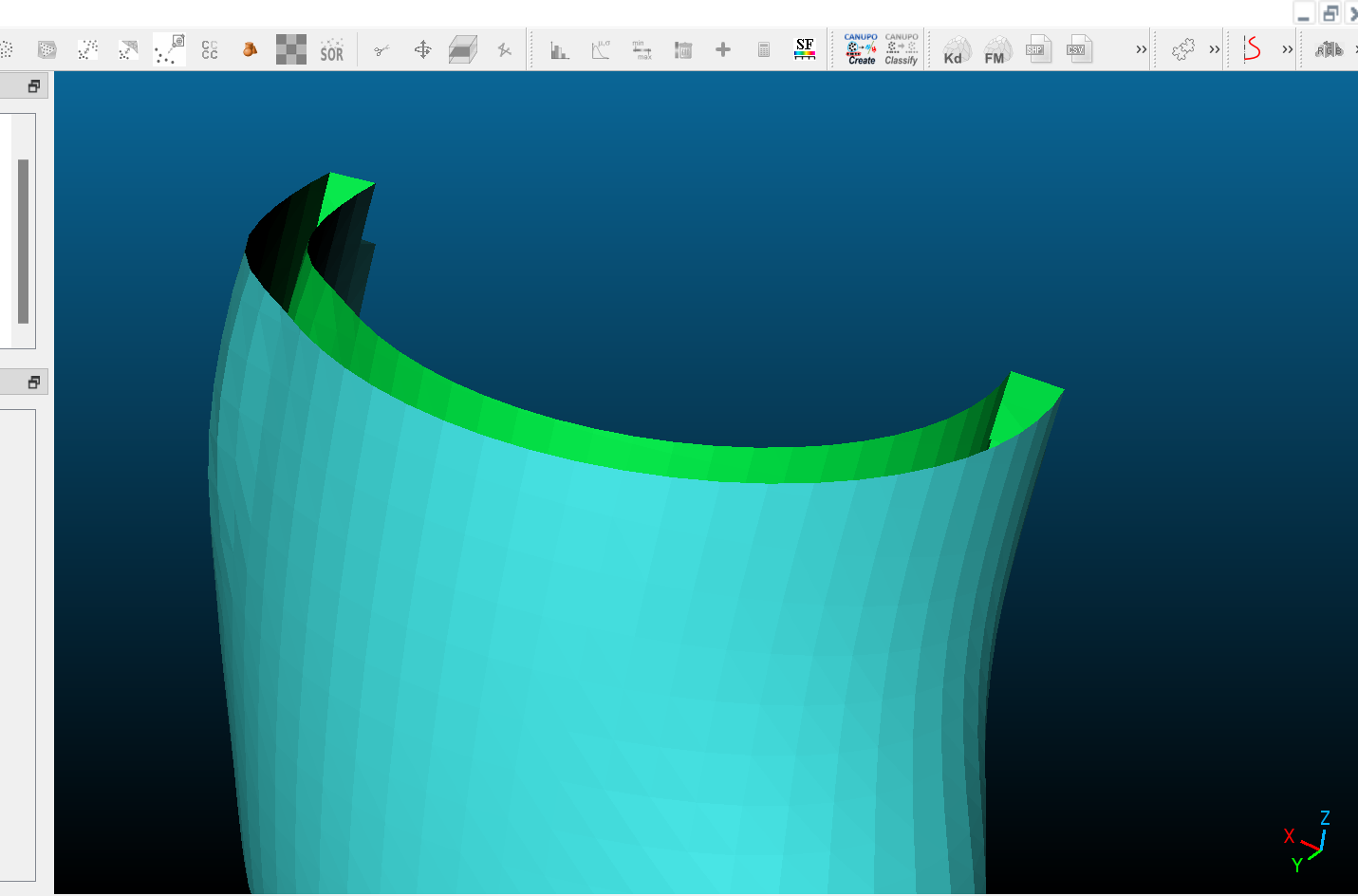

DA523
Posts: 186
Re: cloud offset to compute volume between surfaces
Post by DA523 »
You may try Blender
Extrude faces along normal
ALT+E
check this example (stl mesh)
blenderAltE.zip
(138.25 KiB) Downloaded 604 times
