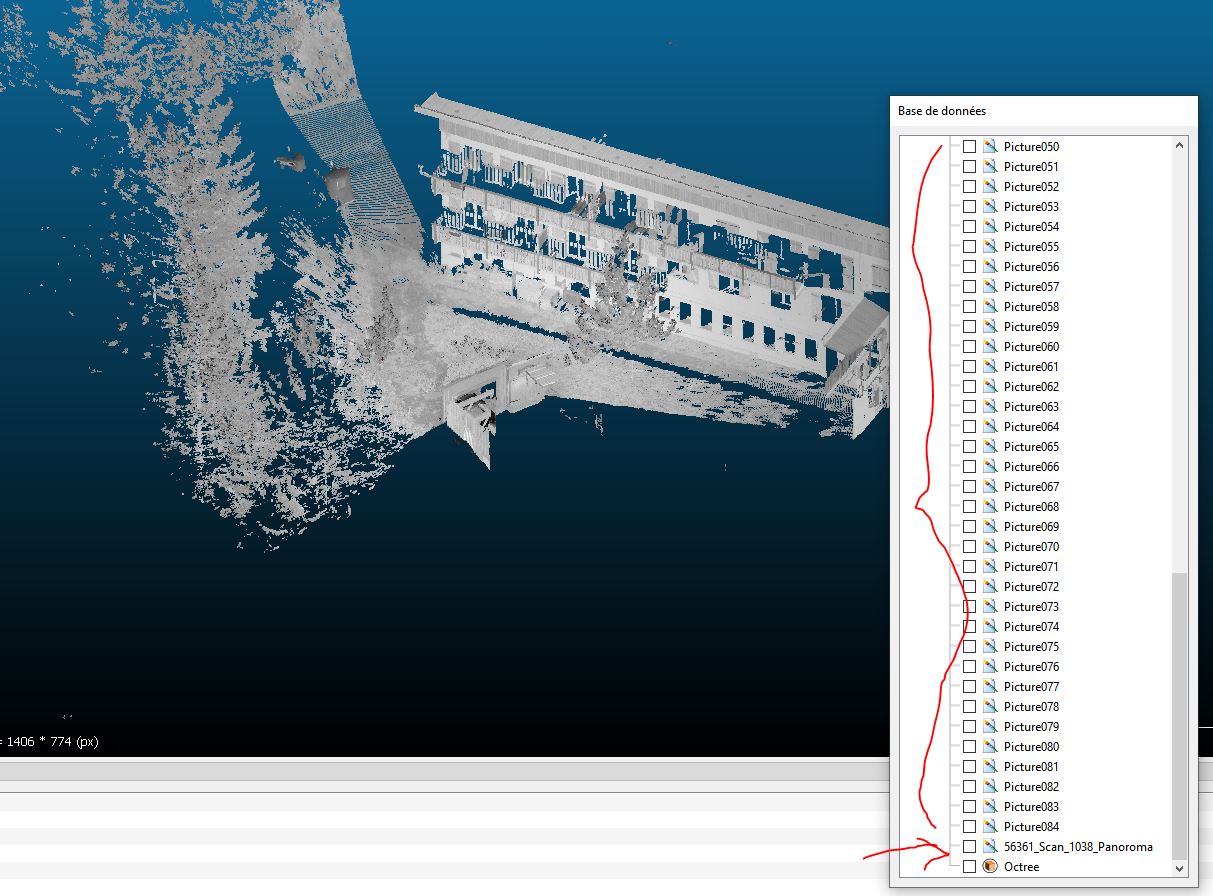

I have imported again that new E57 to see if there was any changed in the file structure from DB view...

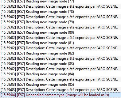

Just to let you know that the native E57 file that comes from FARO SCENE returns a warning in CC console
any idea why ?
thanks
antoine
Re: E57 import / export | file size not same size
So CC doesn't handle all sensor and camera types (so at least the warning is not unexpected).
And regarding the output E57 size, I guess FARO may use 32bits floats to store some values? (I believe CC only uses 64bits for everything).
