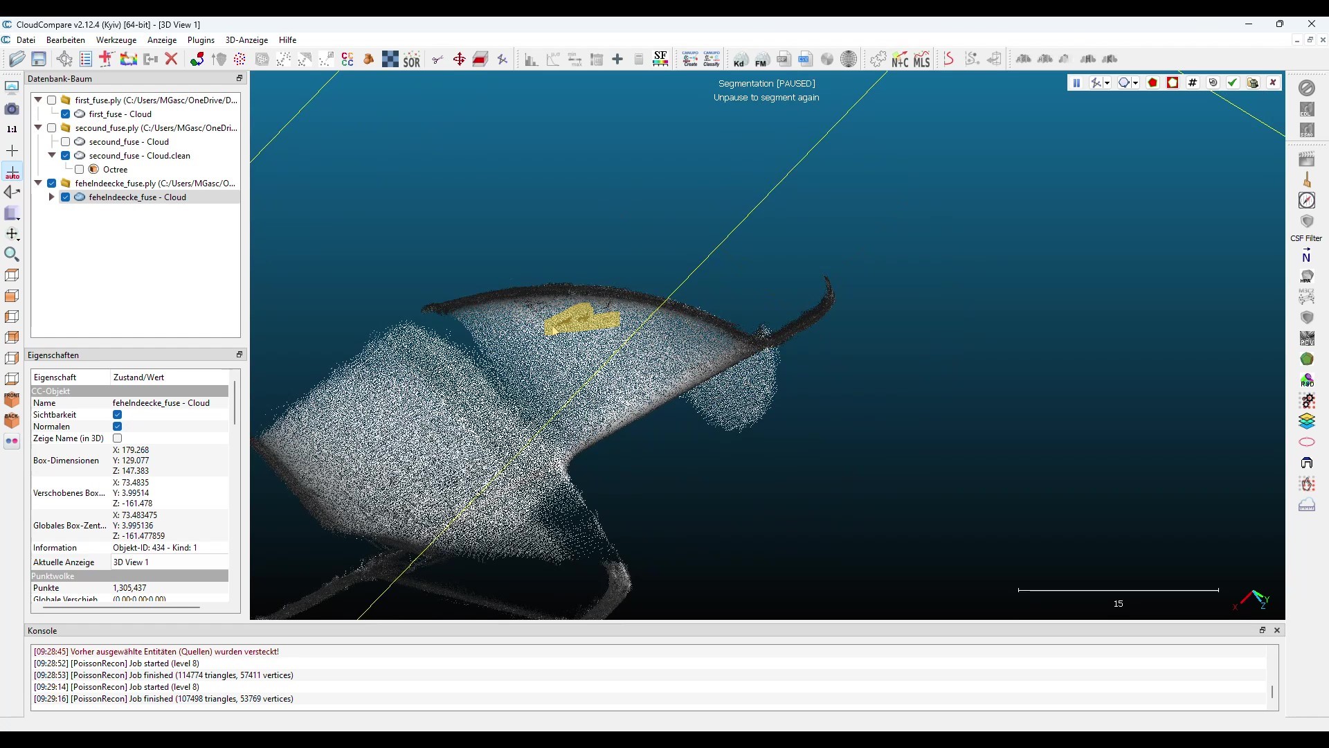

Hello, I have a question if there is a simple way to remove individual points. Namely when these are not directly accessible.
Normally I cut all outliers with the scissors, but sometimes they are so stupid that I can not get there without cutting the contour behind it away.
here in the video you can see it best: https://youtu.be/DDM5syFvbzc

With the latest 2.13.alpha version, you can now set a near and far clipping plane so as to access internal areas (for instance while using the Scissors tool). Just open the 'camera parameters' dialog while in the Scissors tool, and enable/set the right depth for the near or far clipping planes.
