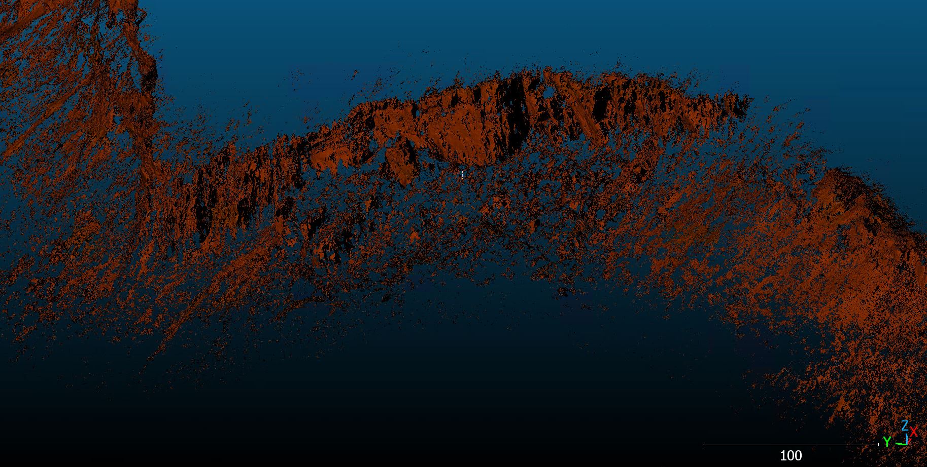

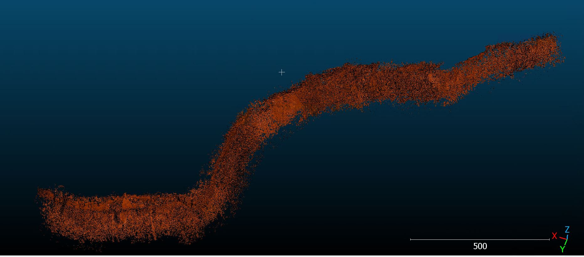

My study site is however not planar. It is a rockwall with an almost 90 degree curve, so the eastern part of it is facing north, the middle part is facing west and the western part is facing north again (see last attach pictures).

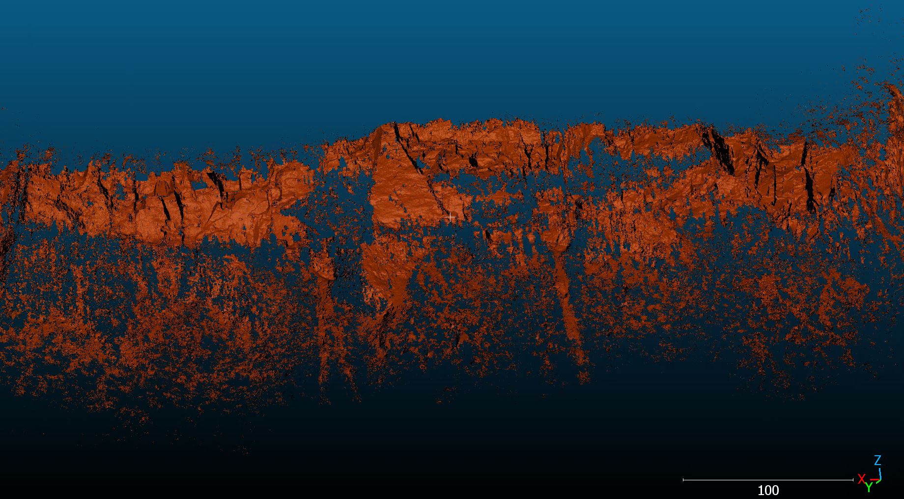

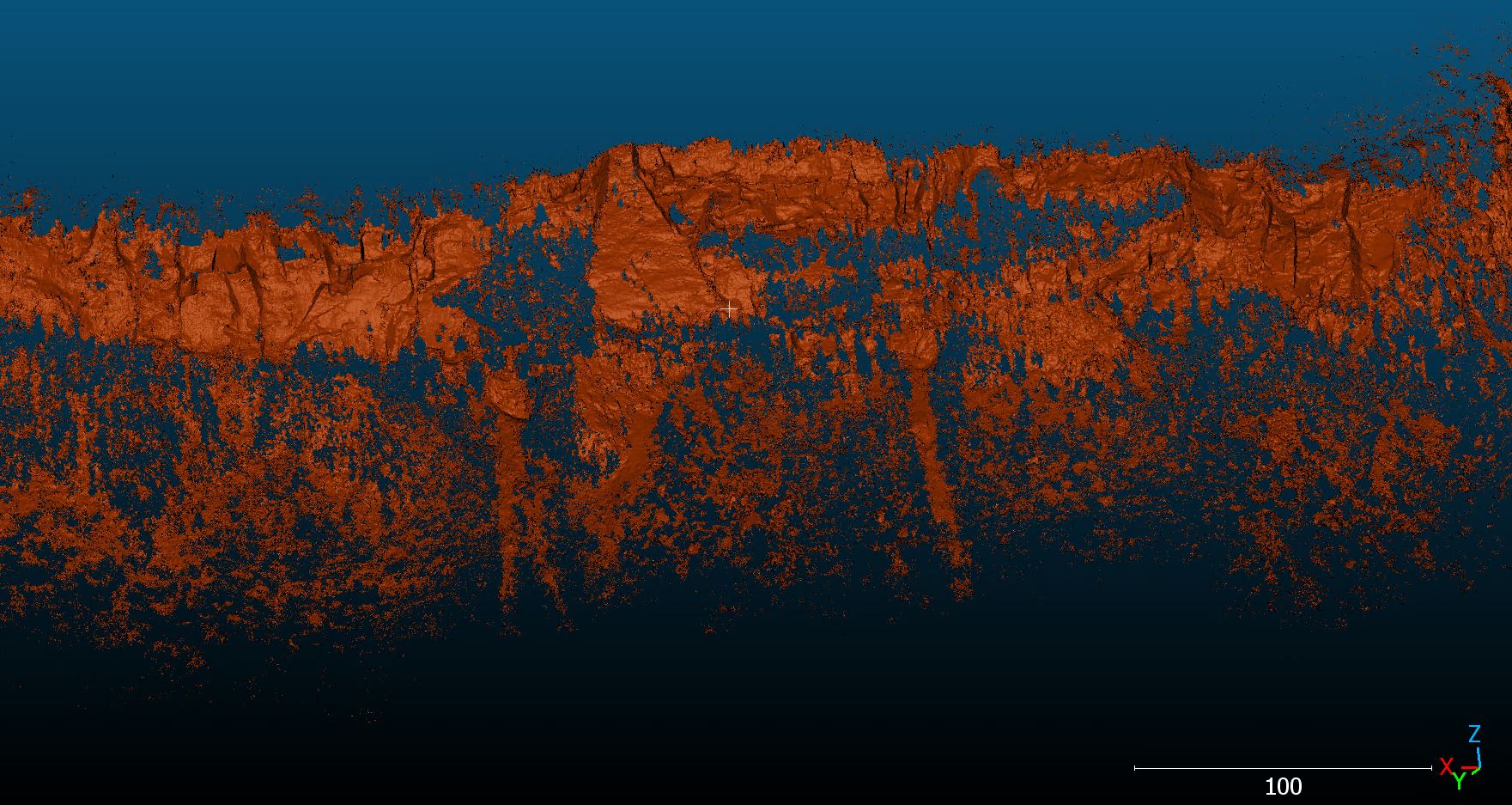

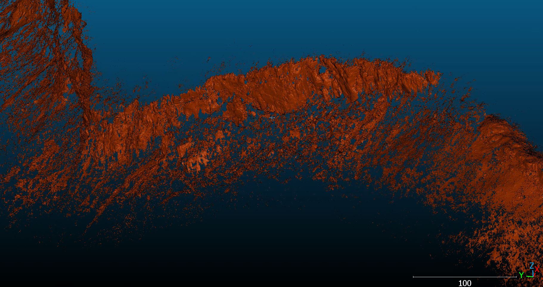

I've tried different parameters (mainly for the prefered orientation) and obviously, Z+ and Z- aren't good because my rockwall is vertical, but Y+ seems better for the rockwalls facing north (Y axis) and X- seems better for the rockwall facing Ouest (X axis). As you can see in the attach pictures:
North facing rockwall with normals computed in Y+ are looking good, but west facing wall has some "shadows"
West facing rockwall with normals computed in X- are looking good, but north facing walls has some "shadows"
I feel like I could use the same "prefered orientation" (Y+ or X-) for the whole study site even tho both of them are better for some sections and worst for others. I am however wondering if I should segment my study site in 2 (north facing walls and west facing walls), apply the propper normals computation and then merge them back together?
