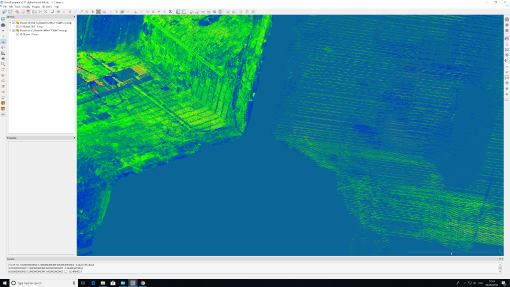

When applying a transformation matrix to any point cloud (apparently regardless the number of points) using CloudCompare v2.11 Alpha, the quality of the data decreases -the point clouds lose accuracy as in the screenshots attached (they are the same point cloud. Left: original; Right: transformed).
Issue after applying transformation matrix2.png (641.82 KiB) Viewed 18817 times
This does not happen when transforming the point cloud with the Translate/Rotate tool.

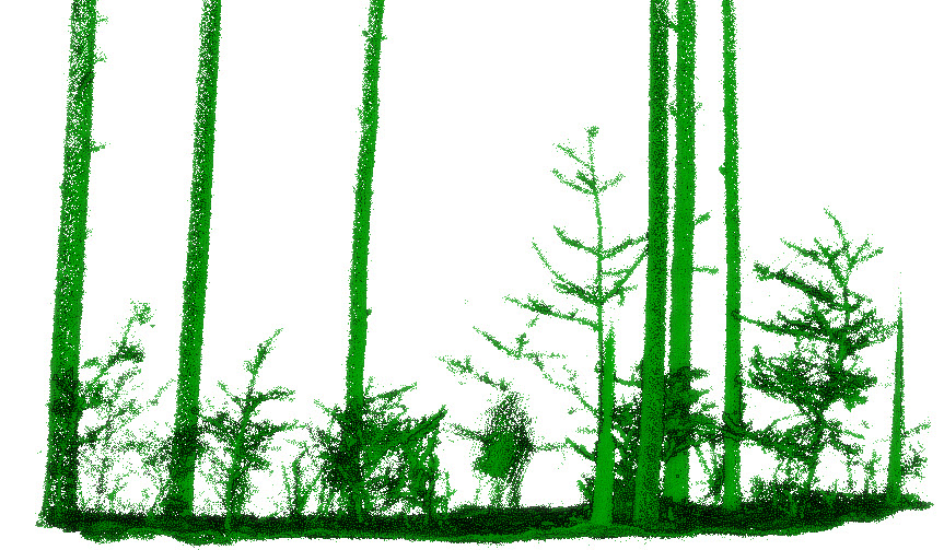

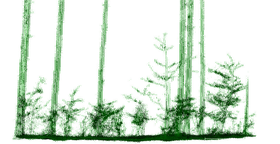

I have the same problem, I'm losing the precision of the point cloud after the application of the transformation matrix. You can see below how my point cloud looks like before and after transformation.
before:
after transformation:
I want to transform my data from a local coordinate system to a national coordinate system. I further steps I'll want to process data and get the georeferenced output which will be ready to use in the field with GPS app.
Is there a way to do it without losing the precision ?

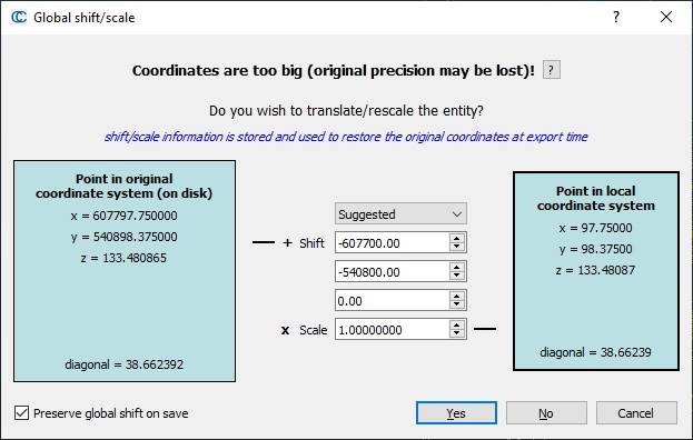

And when you input such a transformation matrix, CC doesn't ask you to apply a Global Shift? (if yes, then you should accept this temporary shift).
Which version of CloudCompare are you using?

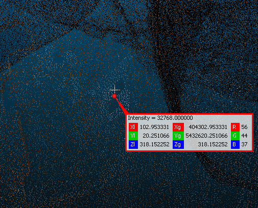

Hum, that's weird. On my side, with version 2.12.0, I see:
Can you check that your 'File > Global Shift settings' dialog has the right values? (should be 10^4 for coordinates, and 10^6 for the diagonal).

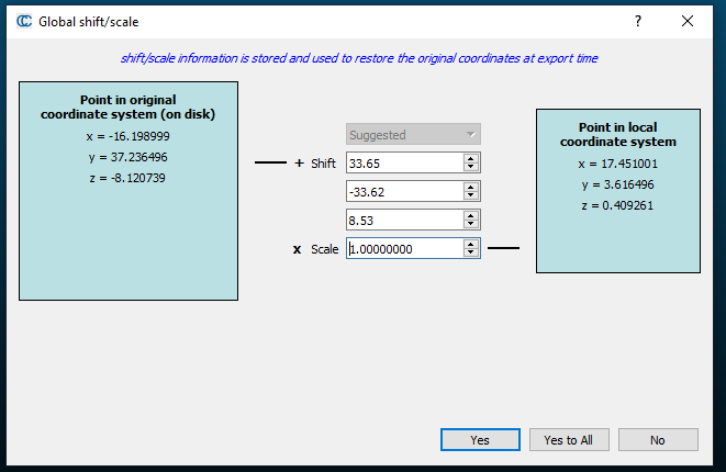

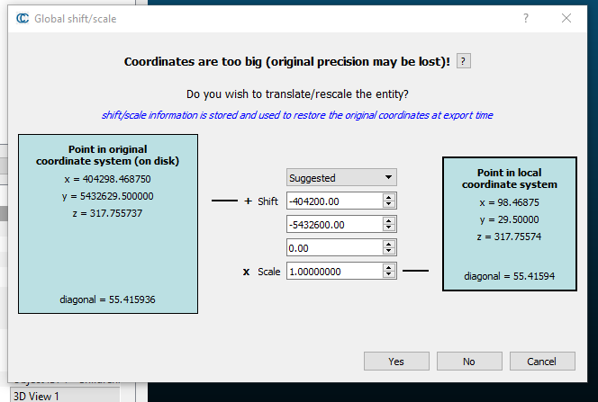

Import shift is the same for both and i press YES
then afterwards while applying the transformation there is this option
shift2 pre trafo.PNG (24.58 KiB) Viewed 17894 times

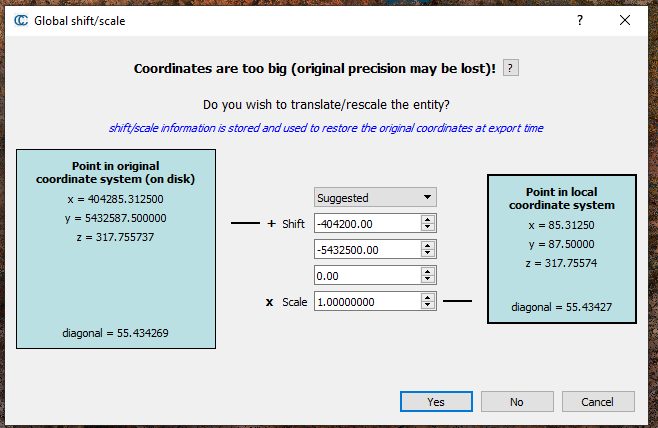

Now there are two cases

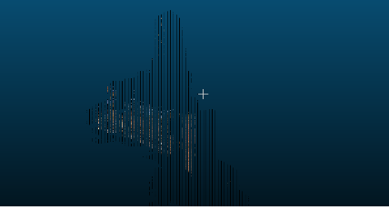

1) If i go NO for the transformation shift i get this which is just wrong
no for shift2.PNG (7.05 KiB) Viewed 17894 times

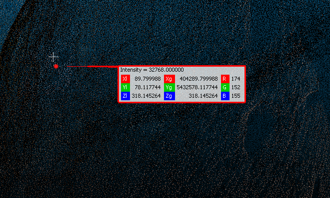

2) If i go YES for the Transformation shift i get this result for a random target which coordinates i know which is slightly wrong
yes for shift2.PNG (150.83 KiB) Viewed 17894 times
as i said, only NO for the shift at the beginning(first picture) and yes at transformation right here gives a good result
