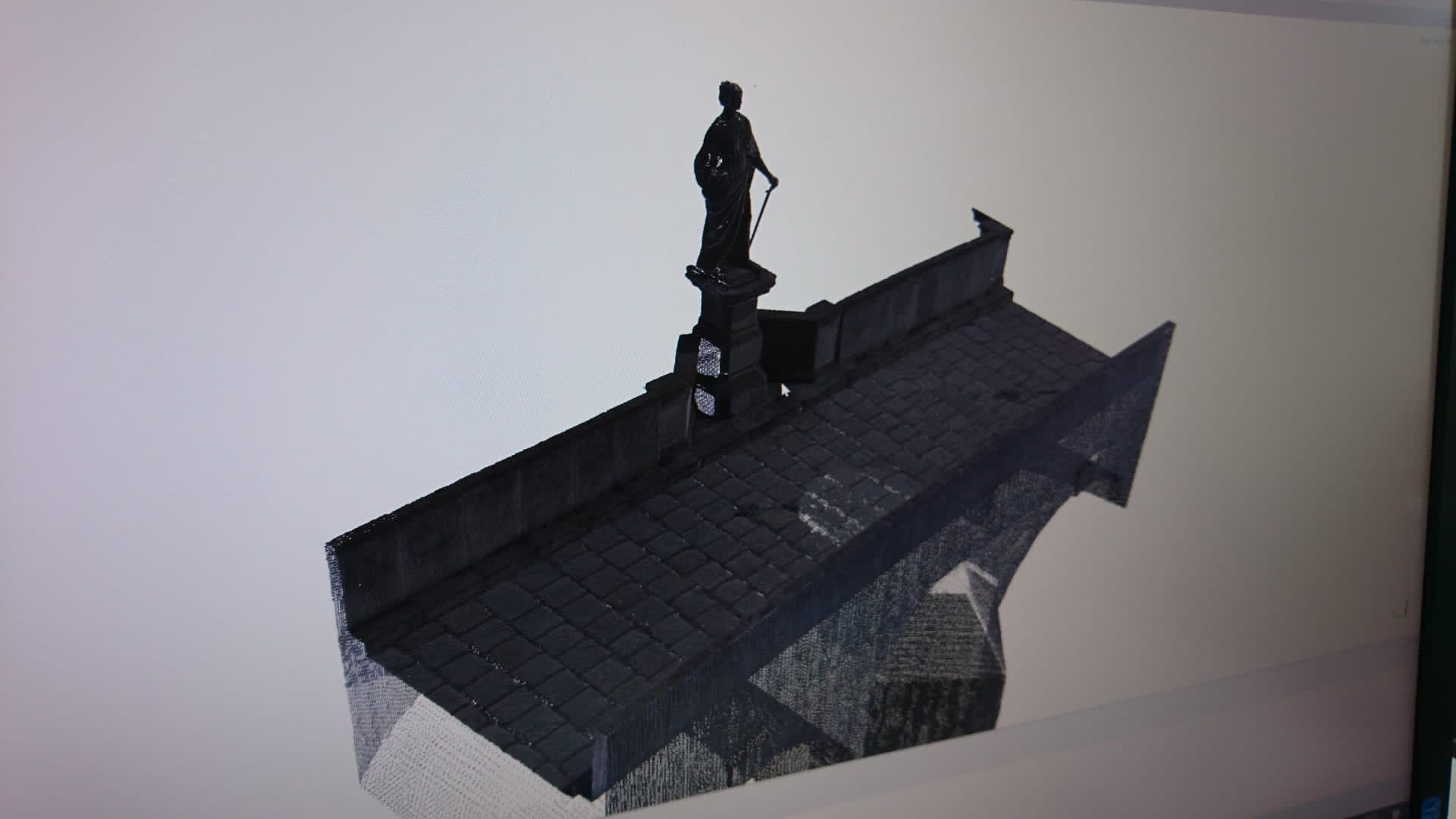

I have scanned a part of a bridge. The following picture shows the pointcloud.

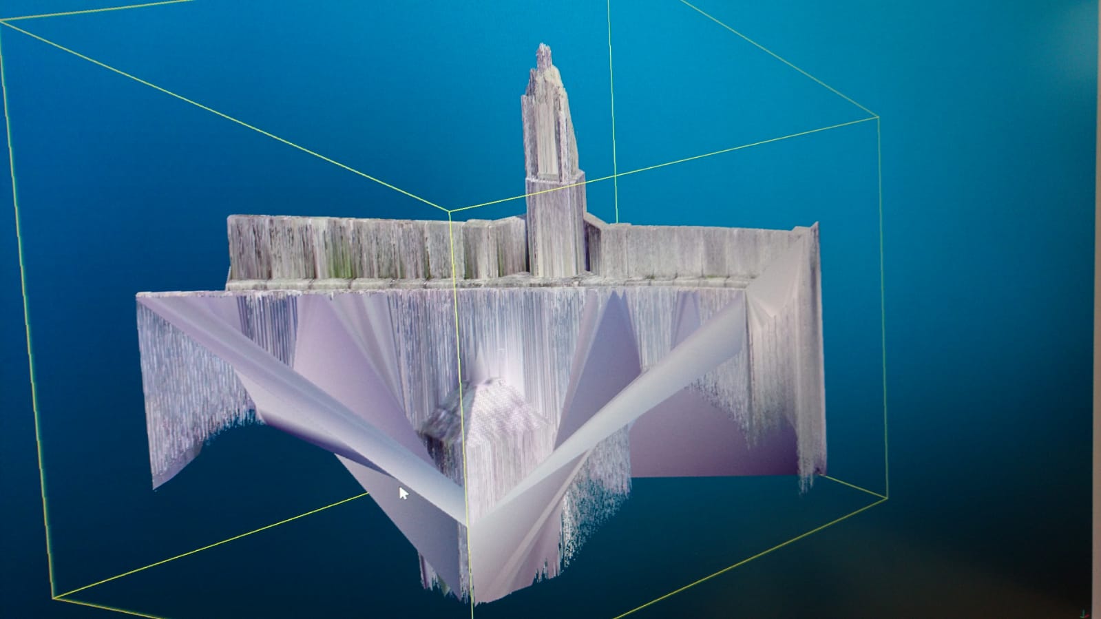

The mesh I wanted to create looks like this:
Foto 21.10.21, 20 51 21.jpg (92.76 KiB) Viewed 1669 times
Can you tell me what I've done false in the settings?

Have you use the Delaunay 2.5D algorithm maybe?
I fear your clouds is definitely not '2.5D' (but more '3D') and you should use the Poisson Reconstruction plugin instead (see https://www.cloudcompare.org/doc/wiki/i ... n_(plugin))
