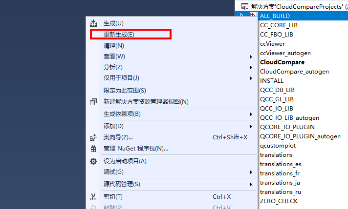

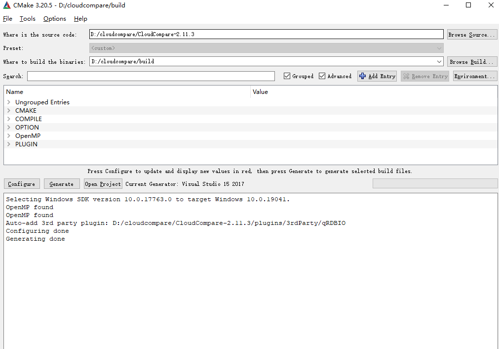

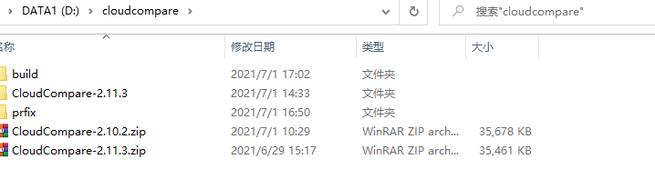

1. Create a folder in the d drive as shown in the figure
2. Select this in cmake
Click on configure and generate
3. Find the sln file in the build folder and open it with vs2017
Right click all_build and click regenerate
Right-click ALL_BUILD, click Regenerate

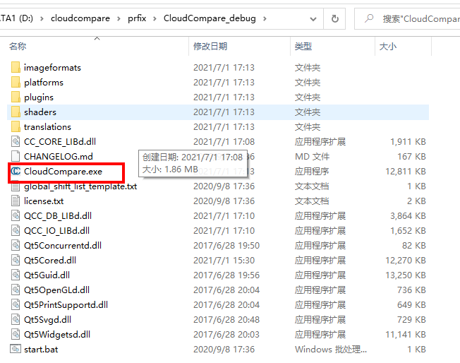

4. I get this in the file
Double-click to open and display

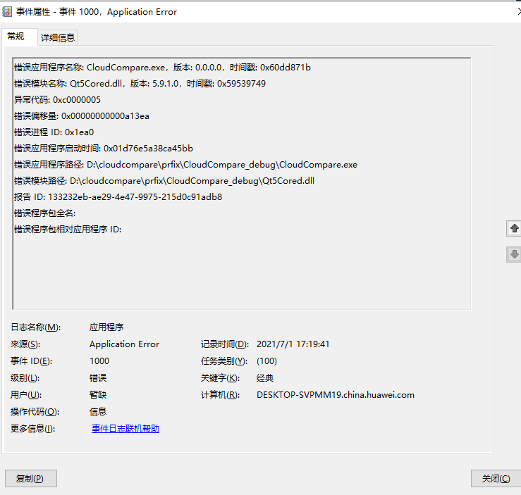

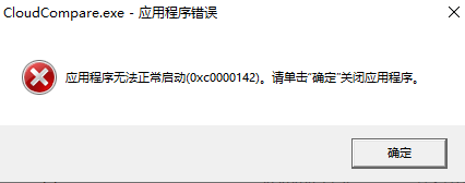

In windows event viewer, it shows this.
can you help me

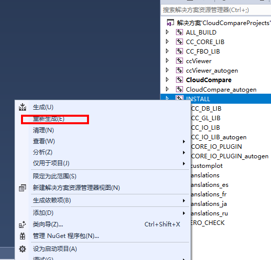

the last picture

But I compiled cloudcompare2.10.2 in the same way and it worked.
xiaolu
Posts: 36
Joined: Fri Apr 02, 2021 9:42 am
Re: Win64 can't open cc after compiling, it shows 0xc0000142
Post by xiaolu »
Today I was able to compile and run successfully with qt5.12.5.
But I am using qt5.9.1 in linux, I need to port the program to windows, in order to avoid unnecessary trouble, I still hope I can compile with qt5.9.1 successfully.............
xiaolu
Posts: 36
Post by xiaolu »
I tested it today
cc2.10.3 qt5.9.1 works
cc2.11.3 qt5.9.1 not work
cc2.11.3 qt5.9.2 works
I think it's because cc2.11.3 and qt5.9.1 are in conflict.
But I don't know exactly what's wrong.
Please tell me why :(
thanks~
