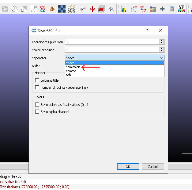

Please can you add an option to use .csv extension as extension in file name instead of .txt
This will save our time .

Now I have to use file manager to manually rename (points.txt) to (points.csv) so QGIS can accept it for layer import
Also, it will be helpful to set default separator to comma instead of space in ASCII saving box (or let CC remembers last choice"

2- However CC does not remember other parameters (separator "," or space precision etc)
3- In Linux CC saves settings in /CCCor/CloudCompare.conf including parameters (separator "," or space and precision etc) but unfortunately it can not remember (bug??)
4- I changed source file AsciiFilter.cpp to change default ASCII file extension to CSV and to change default separator to "," after I compiled CC changed its parameters to to CSV and ","
