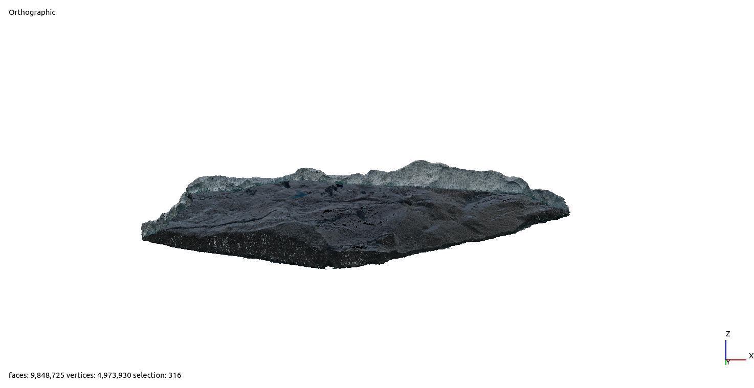

I have an open mesh of icebergs generated from Agisoft Metashape and I'd like to estimate its volume. Now, the issue is that the mesh is only from the top and the bottom is open. So I think, I need to do is close the mesh using a plane at the water line, I know that the plane needs to be at a certain z. Then I believe, I should be able to estimate the volume using the CloudCompare.
So do I understand this correctly? How do I exactly go about closing the mesh using a plane?

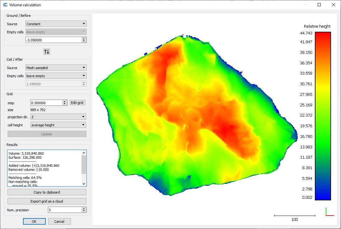

Re: Close a mesh with a plane to estimate volume
When you refer to "sea-surface in the model", do you refer to to the small blue "triangle" in the middle? Is it really at sea level?
As you said you wanted to "close the mesh" to compute the volume, I would have simply used the plane "Z = -3.09" as the ground/before level.
This way, you can compute almost the same volume by comparing the dense point cloud sampled from the mesh, and this plane:
Isn't it what you wanted?
P.S.: here I only used 10M. points, therefore I kept a cell size of 0.5 (meters?), but one can use a finer grid if you sample more points.

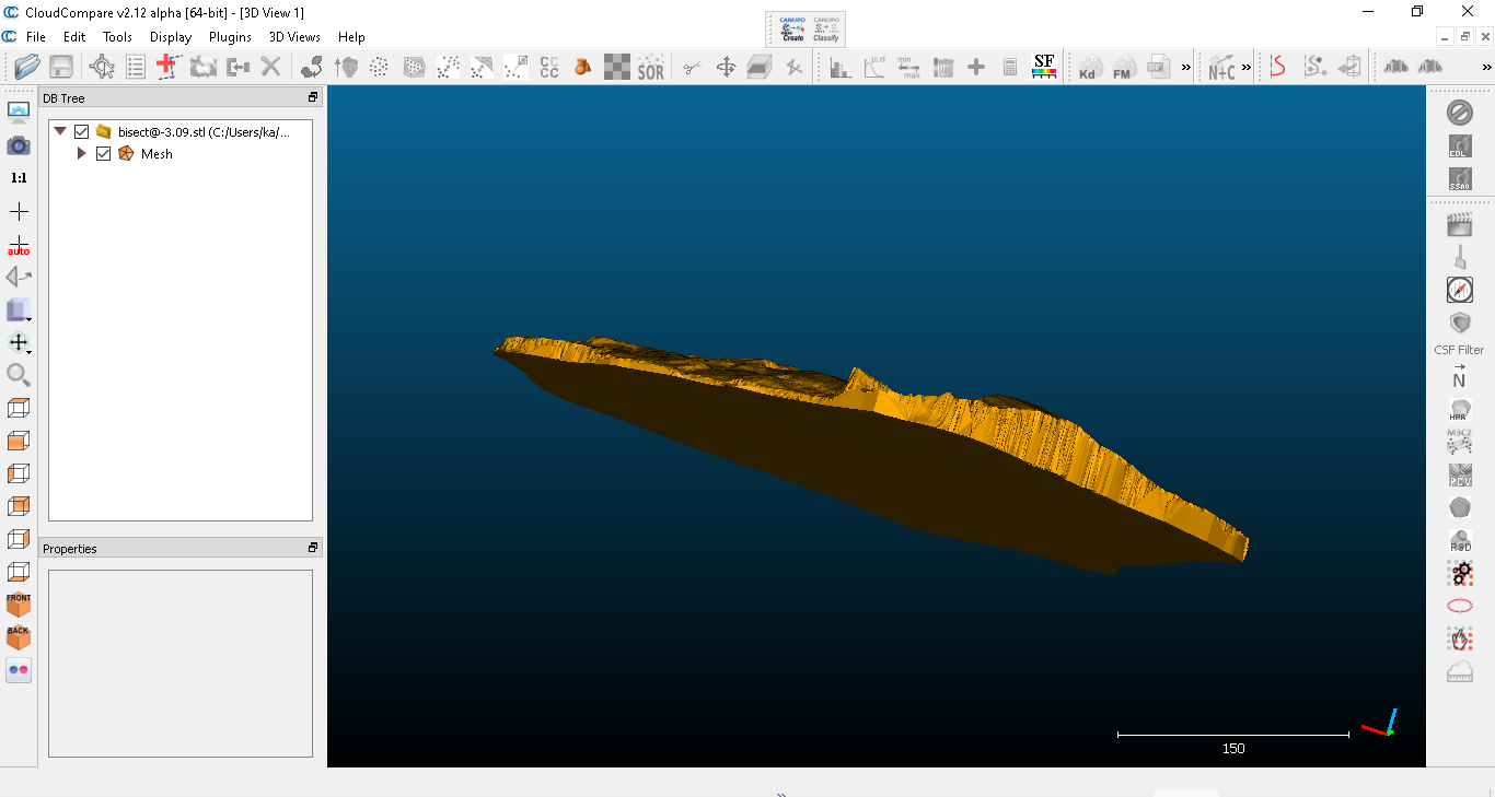

DA523
Posts: 186
Post by DA523 »
please check my trial
CloudCompare
Edit--->Subsample (if old PC)
Edit-->mesh (max edge 23)
Save mesh to STL
Import STL to BLENDER
Extrude (EZ-30)
Bisect at -3.09 (outer , Fill)
Export STL
Find volume from CloudCompare
Edit-->mesh-->volume
=3.3 m
please check attachment
