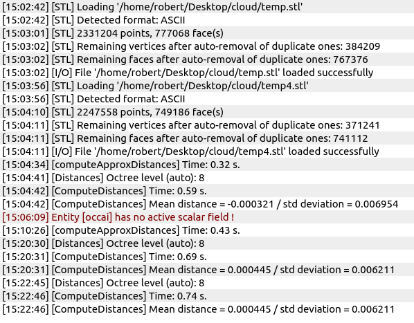

This is a great tool, with really nice documentation as well! I'm using it to see differences in STL files, and within the GUI it works great, but when using this command
Code: Select all
cloudcompare.CloudCompare -o temp.stl -o temp4.stl -c2m_dist
It fails with the error:
Code: Select all
No point cloud available. Be sure to open or generate one first!
The images show the console output. Not sure if there are any additional command line steps I need to take in addition to loading in the files, but according to the documentation I seem to be doing it correctly?

Yes, the C2M command is meant to compare a Cloud (C) with a mesh (M). In the GUI version, the tool automatically uses the vertices of the compared mesh to do the calculation. But not in the CLI version.
You have to chose between two options:
- use the same strategy (compute the distances on the compared mesh vertices only) with the -EXTRACT_VERTICES option after you have loaded the compared mesh (it should be loaded first)
- sample points on the compared mesh (it's better if the compared vertices density is low) with the -SS tool (and don't forget to remove the loaded mesh afterwards)
