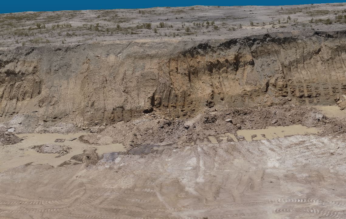

Hey guys,
I have a few 3D colourised meshes (.OBJ and .PLY files) made in pix4d mapper.
The meshes have a .mtl file and a .jpg file, they are not georefrenced but I georefrence them by using the EDIT>APPLY TRANSFORMATION>AXIS ANGLE>TRANSLATION. I use a offset file pix4d provides.
Now the problem is when I import the mesh it looks perfect
Before moving.JPG (226.05 KiB) Viewed 5685 times

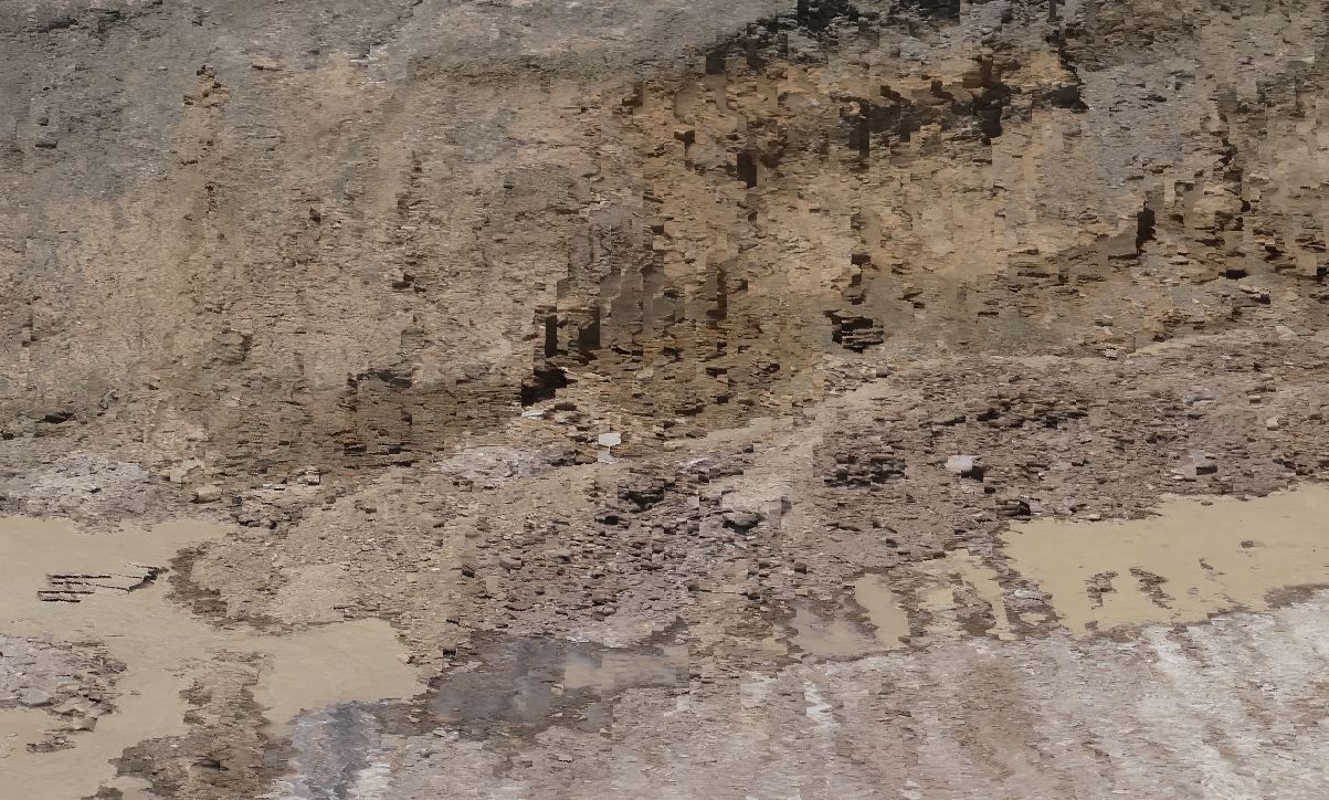

but as soon as i georefrence the mesh the image becomes exremely pixelated or jaggered.
After moving.JPG (246.58 KiB) Viewed 5685 times
I have moved meshes before without any issue but I have not changed anything in this process except the drone I used to for pictures for the mesh.
any suggestions?

Re: Pixelation of 3D meshes
It looks like the coordinates of the vertices are too big.
Do you see it pixelated right away (after translation) or after saving and reloading it?
And does CC suggest to apply a 'global shift' when you transform the mesh coordinates?
