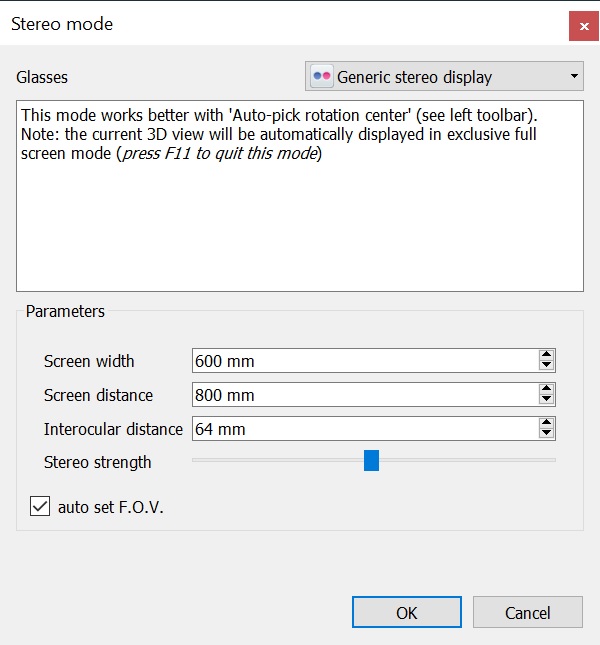

The Pluraview website says that Cloudcompare supports the 3d monitors. How do I set up Cloud Compare to work with the monitor?
Re: 3D Plura View
You have to use the 'stereo' version (2.11). Then activate the 'stereo' mode (the last icon of the 'view' toolbar on the left - see https://www.cloudcompare.org/doc/wiki/i ... tereo_mode).
And then choose the 'Generic stereo display' mode (default values should be ok for the Pluraview screen(s)):
