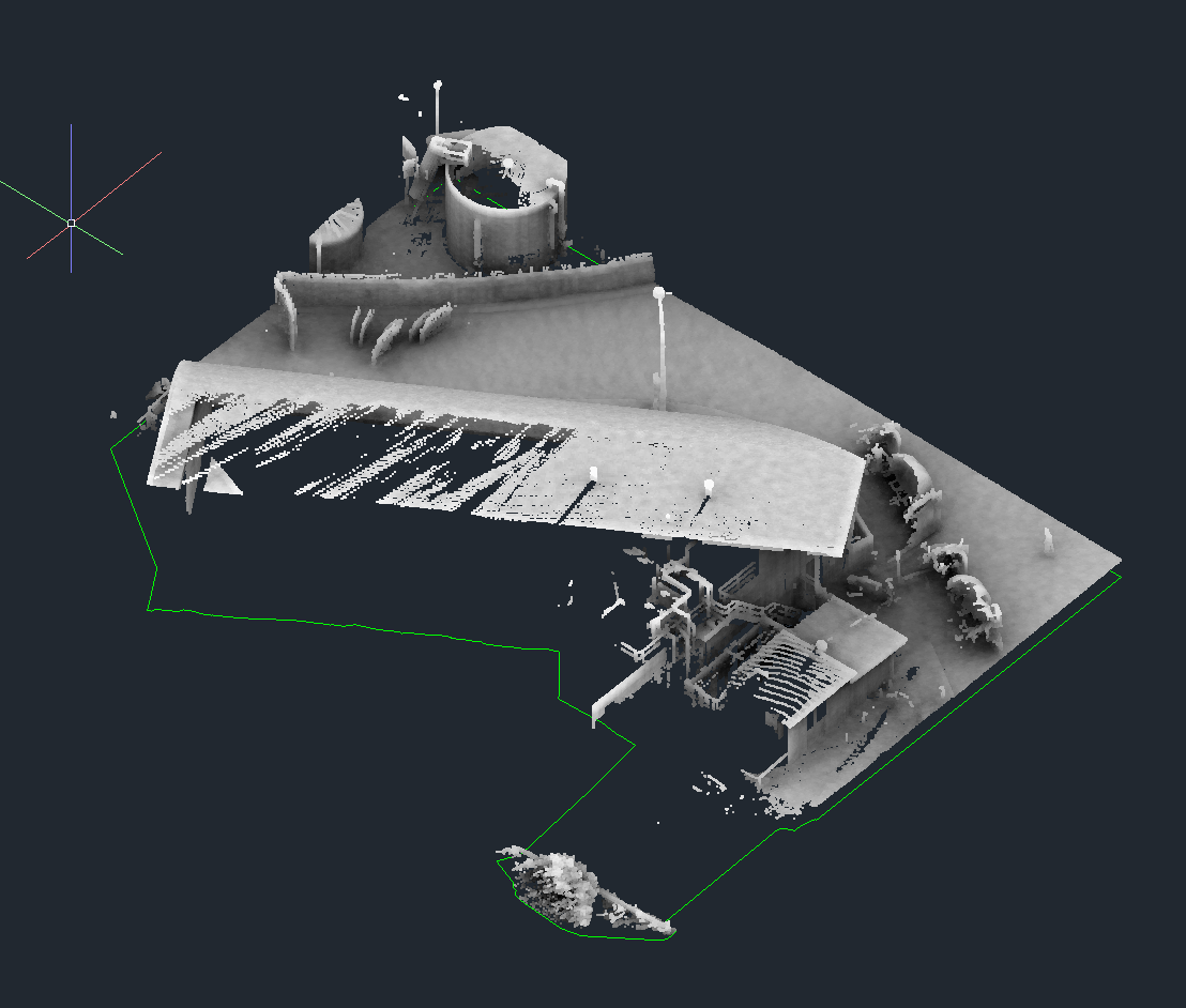

thanks Daniel, that is certainly much quicker
Andrew
20191128 pointcloud perimeter.PNG (246.38 KiB) Viewed 3257 times
