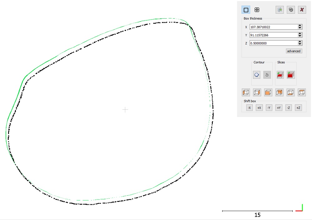

I am selecting two clouds (overlapping clouds to see the changes between them) before selecting Extract Sections Tool, but Section contour ( with Vertices on) show only one line so I can't figure it out how it works. ( clouds cannot be identical due to processing) .
I have tried to upload both clouds here but it was an error for .xyz( invalid format) ( I am comparing a .las to .xyz). Thanks for any input.
