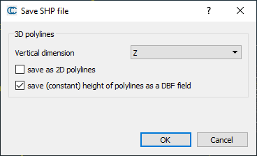

I created contour lines of a point cloud and exported them as a shapefile to open it in ArcMap. It opens successfully but I can't find any height values in the attribute table of the exported shape. My question is: How can export contour lines as .shp with height values included?

Re: Export contour lines as shp with values
Have you selected the right options?

Thank you! :-) I forgot to select the option you mentioned in the screenshot...
