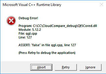

I compiled the program successfully, but when I ran it, I got the error as shown in the attached picture error.png. It seems that there is a problem to call Qt5Cored.dll.
Would you please advise what might cause the error? This is other information for your diagnosis:

It seems to be an issue with OpenGL... What graphic card have you? And does the official 2.10 (or the 2.11 alpha) version works on your computer?

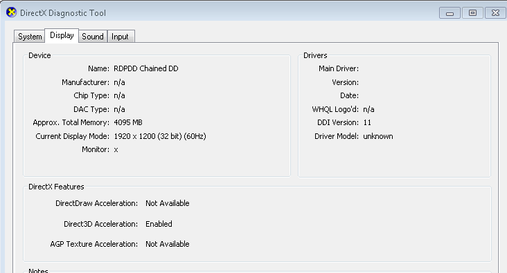

I also tested the executables in another older Dell computer (Win7 64bit, with probably built in graphic card see attached picture). I got the same results (i.e., both 2.10 and 2.11 alpha cannot start, but 2.6.3 beta can). I compiled the github code in that computer and got the same results as well (i.e., compiled successfully, but cannot run).

aha, Daniel. I just found this: I ran the compiled program remotely via Windows Remote Desktop Connection and had the error. However, if I just started the program locally, it worked great. So, it seems that the 2.10 and 2.11 beta do not support Remote Desktop while the 2.6.3 does.
I control my computer remotely at the daily basis to get work done. Is there a way to fix this issue in the latest version? Thanks again.

Yep, since Qt 5, remote desktop access is not always supported (actually it is possible to achieve that, but not with any configuration). Same thing for old Intel chipsets.
