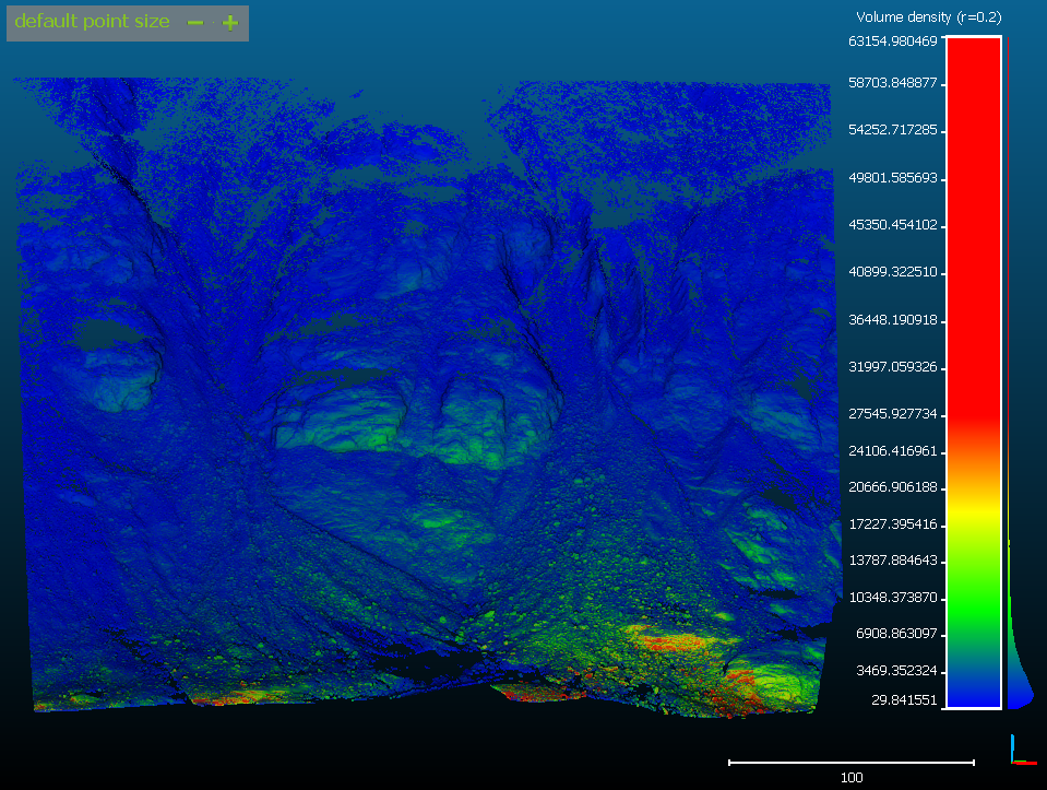

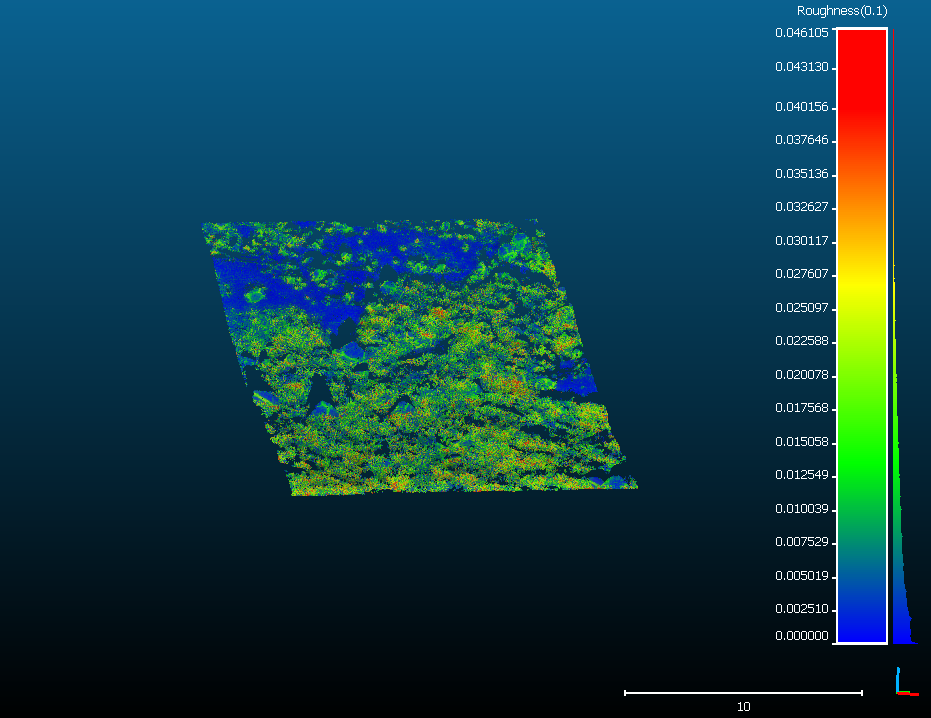

Point clouds have a scale of about 350x400m and each one resulted by the merge of four different scan positions. All the point clouds are composed by 61M points. Attached you can find the distribution of volume density (in m) and the roughness of a flat portion of the moraine.
I tried with the parameters mentioned above and the results seems pretty good...
